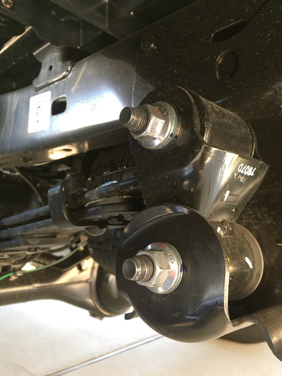

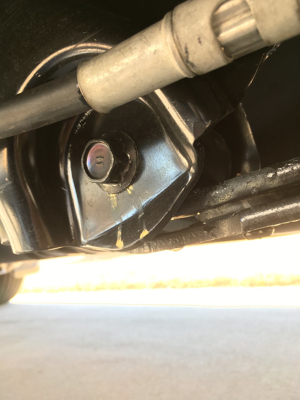

    D754EDB5-3EA9-4FA8-8F84-589A895F4B5C.jpg 391819CF-ED6E-4B21-AF41-3BD16079EEE8.jpg
    @mastro1 i was just getting around to checking my leafs. Please excuse my ignorance I'm not a mech, but like to tinker. Are the bolts/nuts the ones on the rear of the leaf(bottom pic) or the on on the front(top pic). Also on the rear there are 2-one set above and one below.

    Do all 3 of them, one at a time, you will hear a snap sound that means it was tightened on the lift. when you are all tight.. now your suspension is properly preloaded! good to go!!

    Just a suggestion but since you are doing those you should probably check the u-bolts too. They should be torqued to 52 ftlbs per Toyota. My friend works at Toyota and I helped him do mine. The numbers were 52 for u-bolts and 89 for the other ones. I wrote it down so I could recheck them after a few hundred miles.
