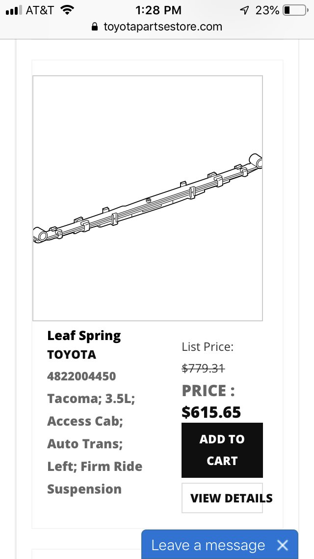

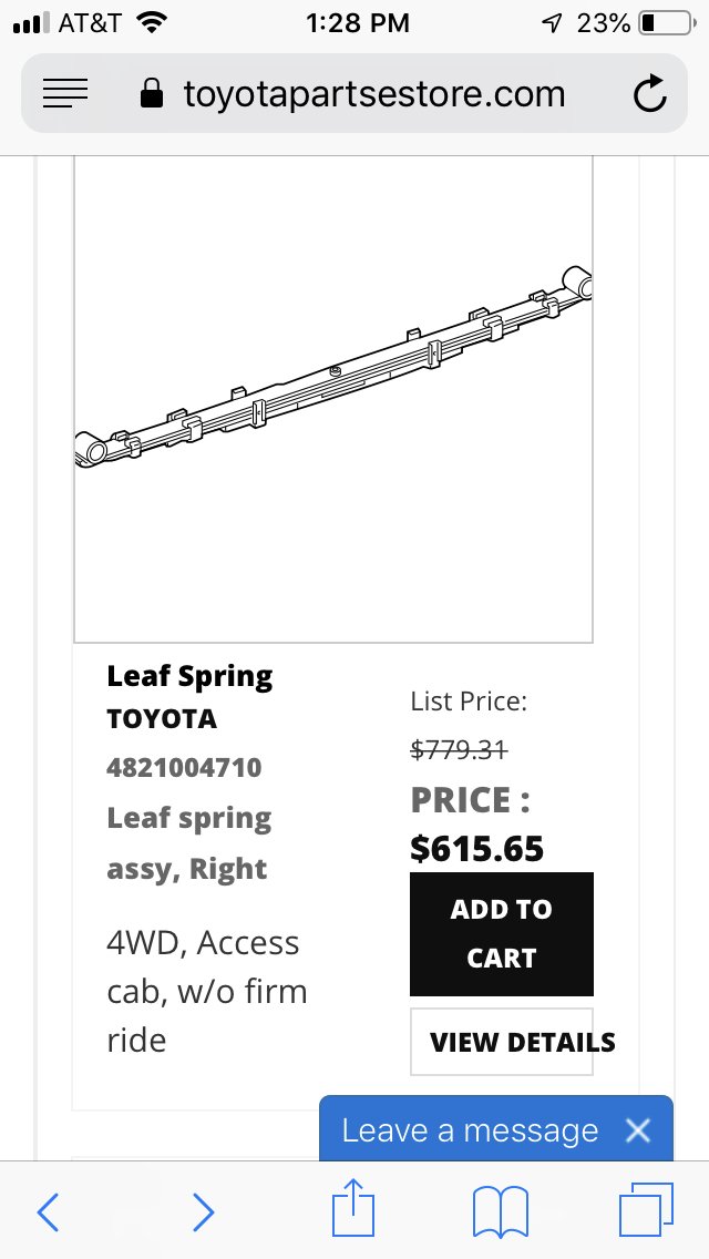

    00E7C0B7-0008-4D46-93D2-126AE0163C14.jpg 975BF7ED-959F-4066-9CE1-60488FAB2634.jpg Having the exact same rumble strip vibration on my stock height 2018 SR5 DCSB 4X2 with TRD OR shocks and coils (7,000 miles) the problem appears to circle back to the pinion angle every time which means the leaf springs Toyota is using are inadequate. Toyota Dealership says it’s normal, even compared it to a used SR5 built around the same time and claimed it did the same thing, unfortunately the truck was sold before I could test drive it.
    It’s interesting if you look into the earlier threads about this T-SB, I think a few pages back here you’ll see a post in this thread with a service ticket picture, that they replaced the rear leaf springs with the firm ride style leaf packs which in theory will help prevent axle wrap and I’m assuming at the same time, pull the pinion angle upwards. Hopefully someone can chime in here to confirm this but I do recall seeing some these leaf spring packs getting flattened out on brand new Tacoma trucks from normal driving conditions / no towing.
    I know from the part numbers on my current leaf springs are considered standard ride, it would be interesting to see if there is a correlation between standard ride leaf springs and rumble strip vibes
    I’m also getting pedal vibes / intermittent pulsations when accelerating through 50 MPH does anyone else notice this too?
    The truck was also previously lifted thus I’m suspecting an issue with the driveshaft itself, being too short for the lift (2.25-2.50” increase in the rear) and not angled right, despite taking angle measurements, shimming and adding spacers under the carrier bearing there was no fixing the thing completely so I took it off. By the way the lift was on the truck for less than a month, drove it maybe 200-300 miles lifted in all, The master technician at the Toyota dealership also assessed and torqued down all of the stock suspension to factory spec after it was removed.
    I’m having the drive shaft rebalanced Tuesday in hopes this solves my problems, at least with the intermittent high speed pulsations however if it doesn’t I’m going to push the buck on this T-SB and try my best to get them to apply it however Toyota is so dang finicky about the trucks they apply T-SBs to which is crazy when it’s obviously an ongoing issue with a vast majority of them, stemming from 2nd generation Tacoma’s, like wtf, 14 years later they’re still having the same issues?
