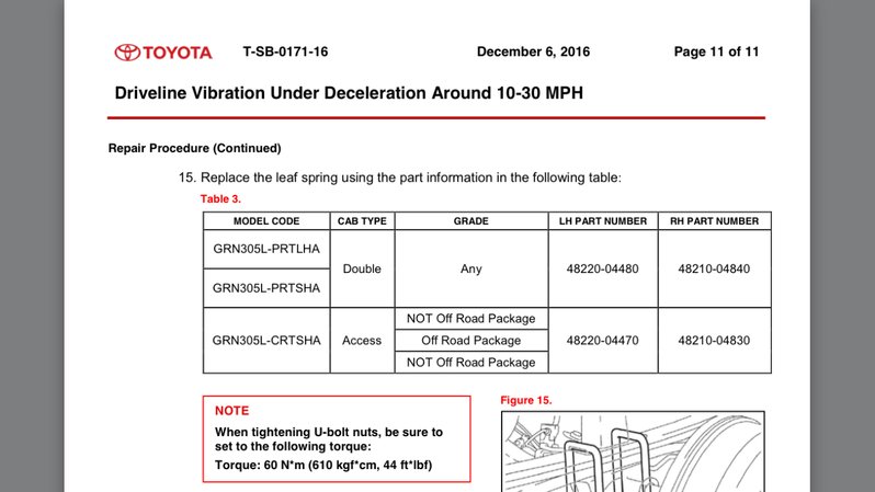

    I guess i'll have my parts manager order me in the new leafs and i'll see what the difference is , hopefully on friday. I do have a very minor vibration when braking. i was chatting with my manager about it and he said we should just do it for the hell of it.

    I want to make sure I'm reading this right...
    Reference the table below for 2016 model year Tacoma vehicles produced BEFORE the Production Change Effective VINs.
    CAB TYPE PRODUCTION CHANGE EFFECTIVE VIN
    Double - 3TMCZ5AN#GM039538
    Does that mean if MY last 4 vin digits are less than 9538, I need the repair?

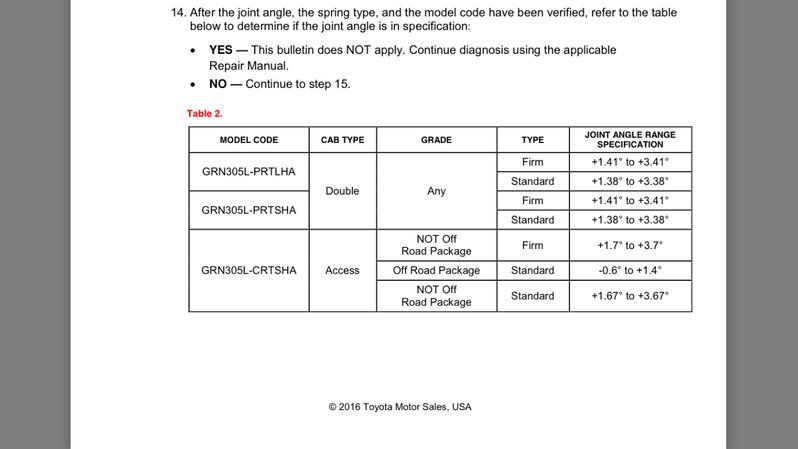

    I'm confused as to whether or not the TRDOR is actually applicable. It says the TSB applies to ALL 2016 NOT Off-Road Tacomas. However, then it goes on to give model information and specify angles and part numbers for off road models.
    Perhaps we're reading it wrong and saying it applies to all non off-road 2016 models isn't meant to exclude the off-roads, just saying that perhaps the off-roads got a fix before the end of 2016 production whereas the other models didn't, so they are all effected while some off-roads are not.

    I think the text is pretty clear.
    This applies if:
    - you have a 2016
    - it is not the Off Road model
    - VIN lower than the table that shows a production change
    So, one would assume anything newer that what's in the table for VINs already has the updated rear suspension and the new steering dampener. The same for the Off Road models, you probably already have it. Or they assume those with Off Road models are more manly by nature, and are not bothered by driveline vibrations (that this TSB clarifies ALL vehicles have.) LOL.

    I believe the Off Road has a different leaf pack than all the other 2016 models.

    My question in all of this is whether or not OR's, Sports, Limited, etc have a different VIN sequence as a unique identifier? For example, I have a TRD O/R and its VIN is 3TMCZ5AN1GM0_____. If this is a common string to different subsets of Tacoma's, I would say the TSB does not apply to us with OR's. If that is a unique set to OR's, then it would definitely apply to us or else they would not have included that in the TSB. For what it is worth, I have had this issue from day 1 of purchase and make sure that it is noted at every service. I have my 15,000 next week and will make note of it again and see what happens.

    I can't say why they excluded the TRDOR, but they did the exact same thing to mine as is described in the TSB, about 3 months ago. Apparently after a technical assistance contact told them to. It remedied it on my truck. I also let them know I was not going away....plus I have a dash video of them bad mouthing me which I leverage every time I go in to get what I want.
