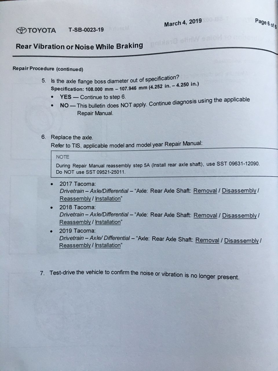

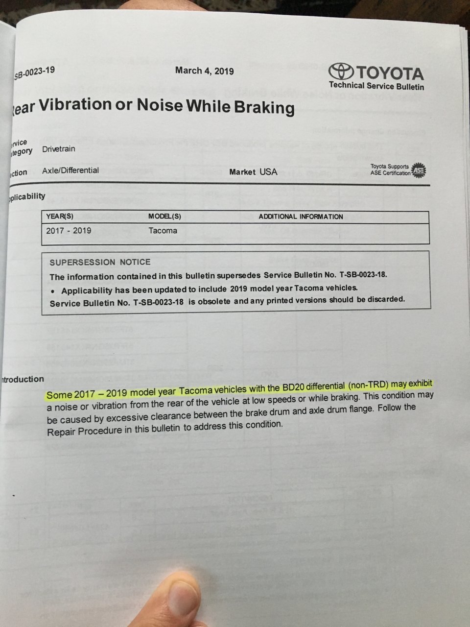

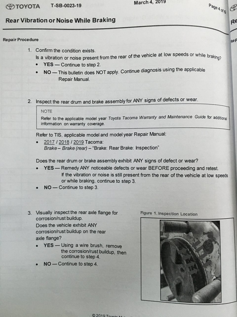

    This is a detail of TSB 0023-19.

    Seems that they’ve extended the T-SB, I was providing the *-18 T-SB before about getting turned down, this explains it.

    Update post-arbitration with Toyota and NCDS.
    Last week I met with the arbitration rep from the National Center for Dispute Settlement, the Toyota Field Technical Specialist who has worked on my last two trucks, my dealer service manager and shop foreman to discuss the buy-back case with my truck. I explained my history with my last vehicle (see my other posts for details) and described the issues with my current vehicle. I described my driving habits as non-abusive, don't tow etc. and I concluded saying that an unknown mechanical issue is causing the rear-drums to warp and cause the rear-end vibration. Then the Toyota FTS went through a description of the work they've done, checked the axle run out, etc. and concluded saying they don't know what it causing the rear drum warping, but that it must be driver habit/use. They also noted that there was slight blueing of the drums showing heat stress.
    I received the arbitration decision today, stating that they side with Toyota and will not buy back my vehicle.
    My suggestion to anyone who feels the vibration: Call Toyota Corporate and open a case with them. This takes 5 minutes to do. Here is their number: 800-331-4331. The more cases that are opened regarding this, the better chance we have at getting a real long term fix, not just replacing drums every 2-5k miles.
    Oh by the way, Toyota corporate says that they will no longer cover brake issues under my warranty since they say the issues are caused by driver habits. I purchased an extended warranty when I bought the truck.
