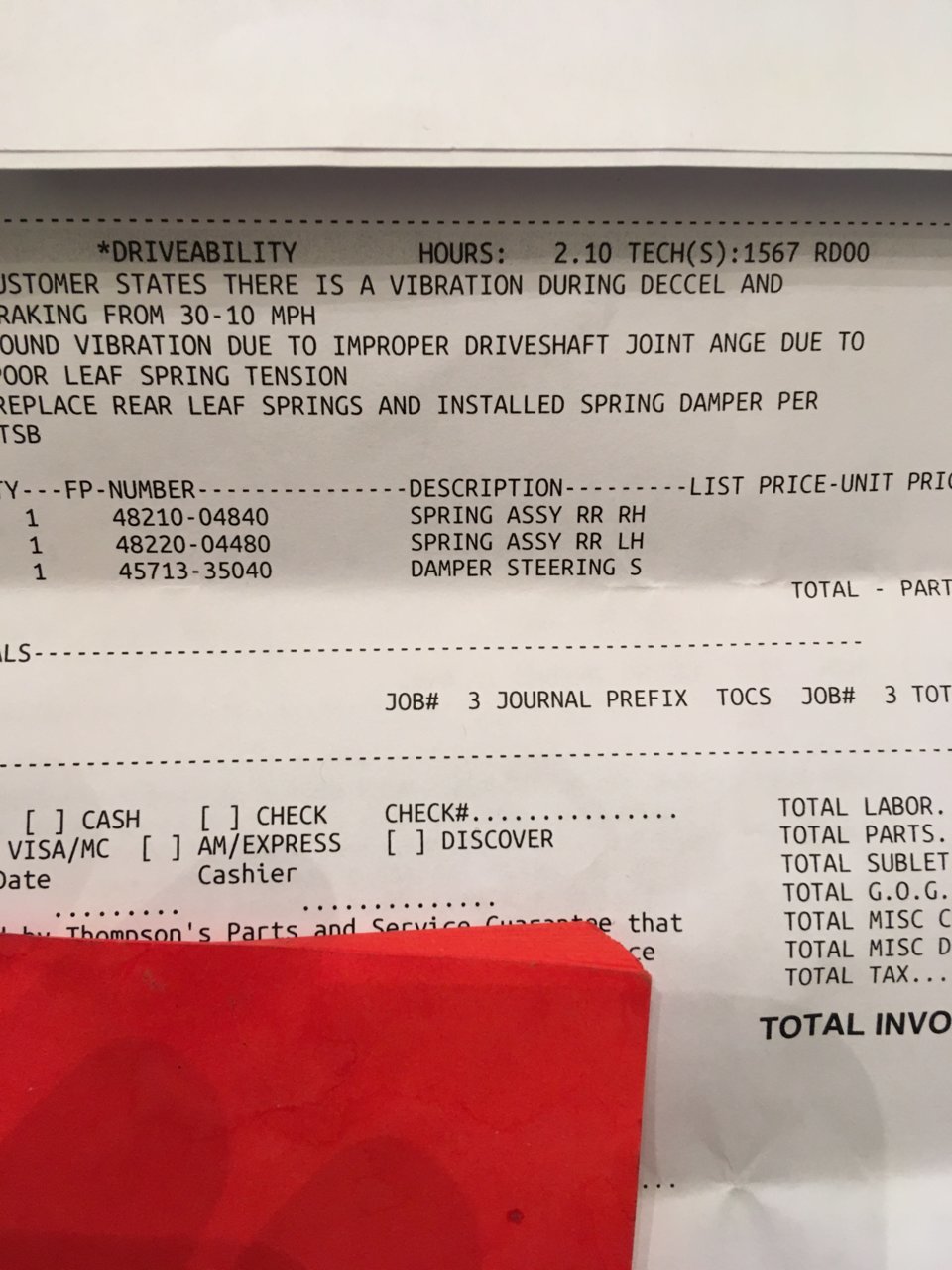

    I did this to solve my issues:
    Weatherby789, PRE-K and Skull like this.

    I just picked up my 2018 sr5 from my dealer , they just did the leaf spring and steering damper tsb which they now have extended to include 18s and 19s but not all models . This was the original tsb released in 2016 , toyota just announced at the end of May that it was being carried into the newer trucks . I don’t have the tab number handy but I saw the printout when I was at the shop , it def helped my decel vibration significantly . I’m sorry I don’t have the vin info for models covered but my sr5 dbl cab 2018 was within the range and it helped a lot .

    The axle replacement and drum resurfacing didn’t do much of anything for mine but the leaf spring replacement tsb that was just extended to include 18 and 19 model years helped with the decel vibes at 20 quite a bit . I can def live with it now
