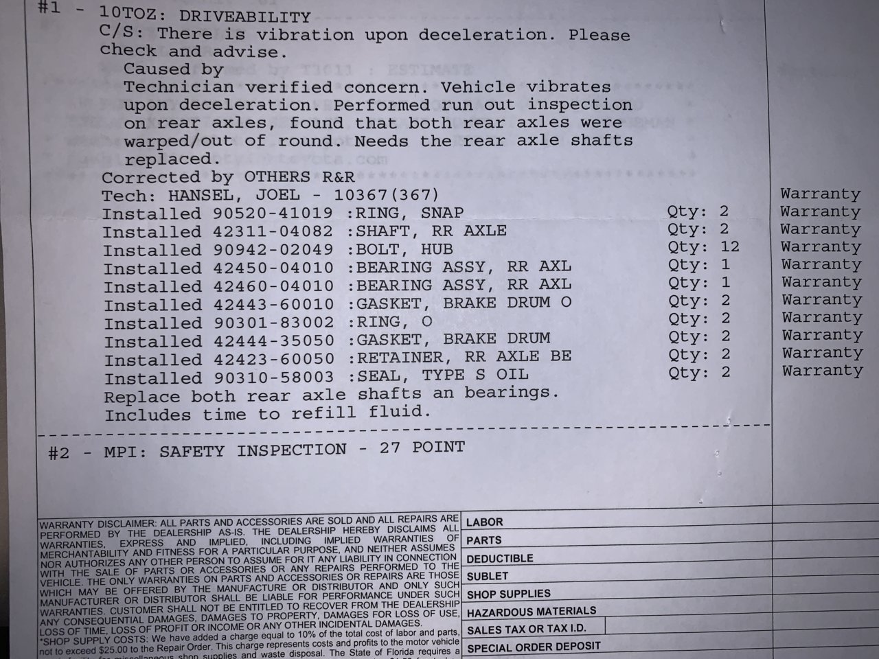

    I’m taking my ‘19 taco in to the dealer this evening and dropping off with them to perform an axle replacement and “other parts” according to my service advisor. When we were talking and he was describing my complaints to the tech, he mentioned the tech said “wow, he must’ve read the service bulletin.”
    Thing is my invoice/report I was provided with from the initial visit that prompted the parts order and today’s service drop off does not state anything about a service bulletin. Just that parts are ordered. So since they are doing an axle replacement, I can only assume they are following the instructions per T-SB-0023-19.
    I contacted my service advisor once I returned home and brought up this TSB (0171). He wanted to act like I didn’t really know what I was talking about and, more or less, said that they have to follow a certain procedural order and can’t just go replacing parts, willy nilly.
    Based on what I’ve read about 0023, it looks like I may be back at the service dept in another 1500-2000 miles for the same issue. At which point I will bring this TSB up yet again. :(

    Well, I got my truck back today. As of right now, after driving it back an hour+ from the dealership, the vibration feels to be gone.
    Here’s a copy of the invoice I received upon pick up of the truck. Still no mention of a repair done based on TSB. Although, that’s what my service advisor stated the tech had essentially done and also stated that this particular tech was familiar with this issue and had dealt with it before. When I said, “hopefully this takes care of it,” (feeling unsure if it would based on what I’ve read), he said “well this may give you a little more piece of mind. You have a 5 year/50k mile drivetrain warranty and an issue such as this is covered under that.” :facepalm:
    Not exactly what I was wanting to hear but good to know that it has a longer warranty life than the 3 yr/36k mile deal.

    If you go to my Toyota and look up your taco it will show your the service history.
    It looks like the same as what was done to mine. The vibration came back after about 500 miles. Good luck!
