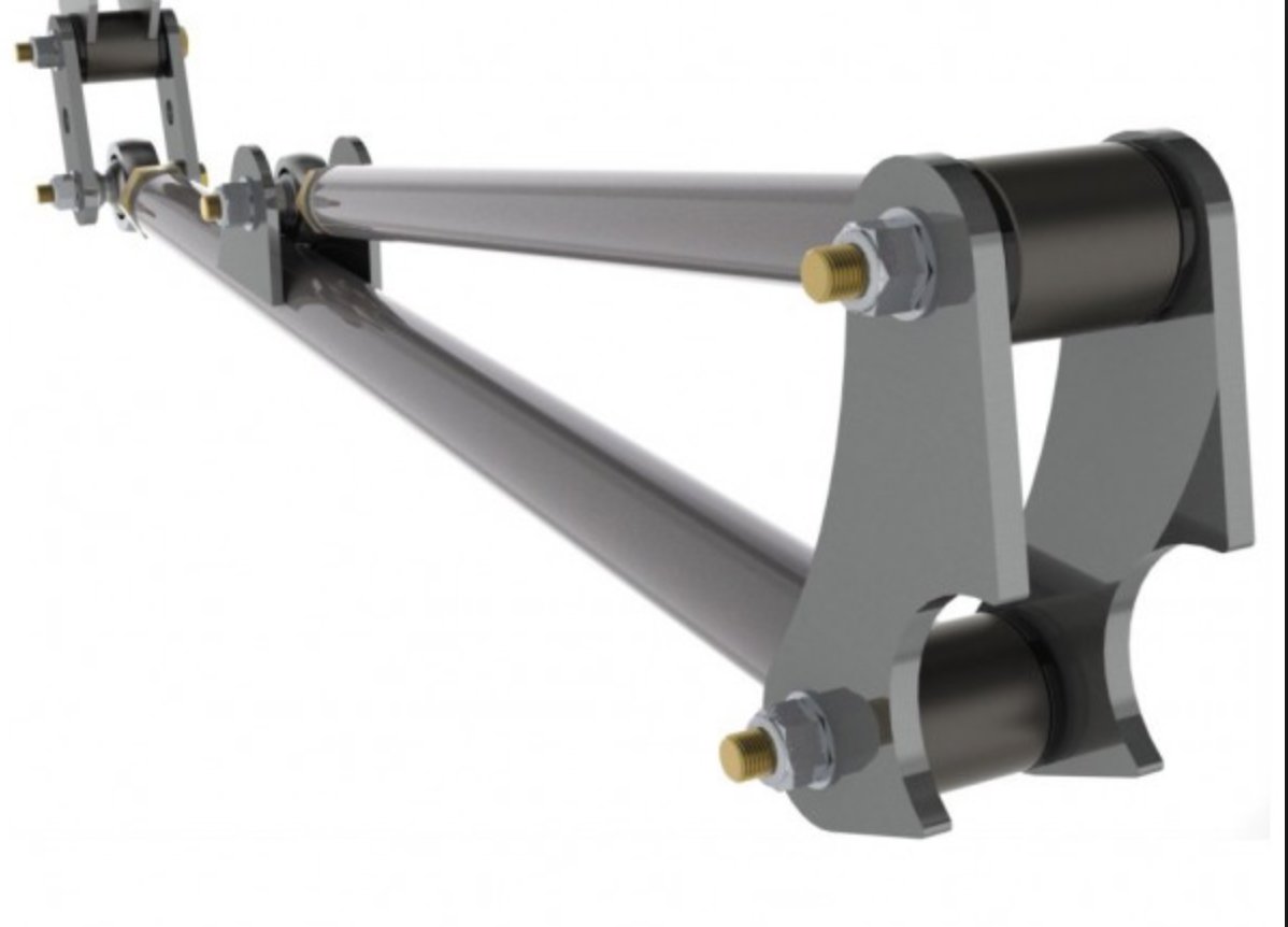

    I have a 18 TRD Sport MT which I actually did not notice this deceleration shimmy until I upgraded the rear suspension with new Deaver leafs and long travel smoothie shocks 5 months ago. Fortunately, mine is very subtle and only noticeable at low speeds (5-10 MPH) but feels like a rumble strip. It is absolutely not associated with the braking system (happens rolling slowly down a hill in neutral from a stop without applying the brake) and is not present under engine load. Before I found this thread and TSB, I wondered if it may have been due to increased angle of the driveshaft U joint since after installing the new suspension, the angle was noticeably increased. When researching about rear suspensions on TW, there were recommendations to use shims under the leafs when lifting a truck in order to keep the driveline U joint angle at a minimum.
    I am no suspension expert, but I'm wondering if this is similar phenomenon to axle warp where the push and pull of the driveline associated with acceleration/deceleration places a torque on the axle causing the U joint angle to increase and driveline to shimmy. Since I have invested a fair amount of $ in aftermarket parts and plan on keeping the truck for a number of years, i have purchased a ladder bar designed to prevent axle warp. Unfortunately, it will need some minor welding/fabrication during install but I am curious to see if this remedies the deceleration driveline vibration. For those interested, I will post back once it is installed (hopefully in the next month or two).

    I want to note that axle WRAP and axle WARP are two different things. I’d say in your case, you’re solving for wrap.
    For my case, which is likely pertaining to the TSB, it is axle warp - which causes brake drum deformation.

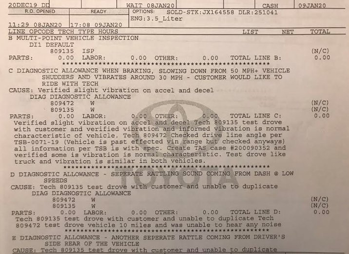

    i've got one ill leave here too for experience purposes... same vibration issue around 30 mph while braking from higher speeds.
    i checked my VIN against the list but it was after the stated Texas vins.... Mine is a used 2018 DCSB Sport 4x4 with 19k miles. (traded a 2007 DCSB Sport with 206k miles)
    I took it in and waited for the tech to ride with me. He seemed to notice it in the floorboard and listened to other potential concerns I had about it.
    They called back and told me they did a transmission software update but the tech could still feel it after driving again.
    They submitted a case to corporate for the next steps on how to proceed.
    Really hoping this works and i don't have to start all over at the next dealer.
    I'll say i went in without showing any knowledge of the TSB but fully described the 'vibration and shudder' at declaration around 30 mph from higher speeds.

    i lost round one... after playing it down initially, i told them i was aware of the known issue and figured it would be written off as a characteristic. I was trying to get the service guy and tech to help me figure out how to get this passed (fail the spec test) through to have something changed. I understand that it might have the same end results but i want it changed as per the TSB to find out. I have a case open with corporate too and they are supposed to contact me tomorrow. Is it really worth taking to the next dealership? I'm pretty sure they will see i just took it to the one across town and it passed. ...thoughts on the TSB used to address?Screen Shot 2020-01-09 at 7.56.34 PM.jpg
