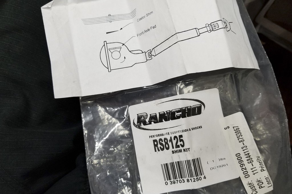

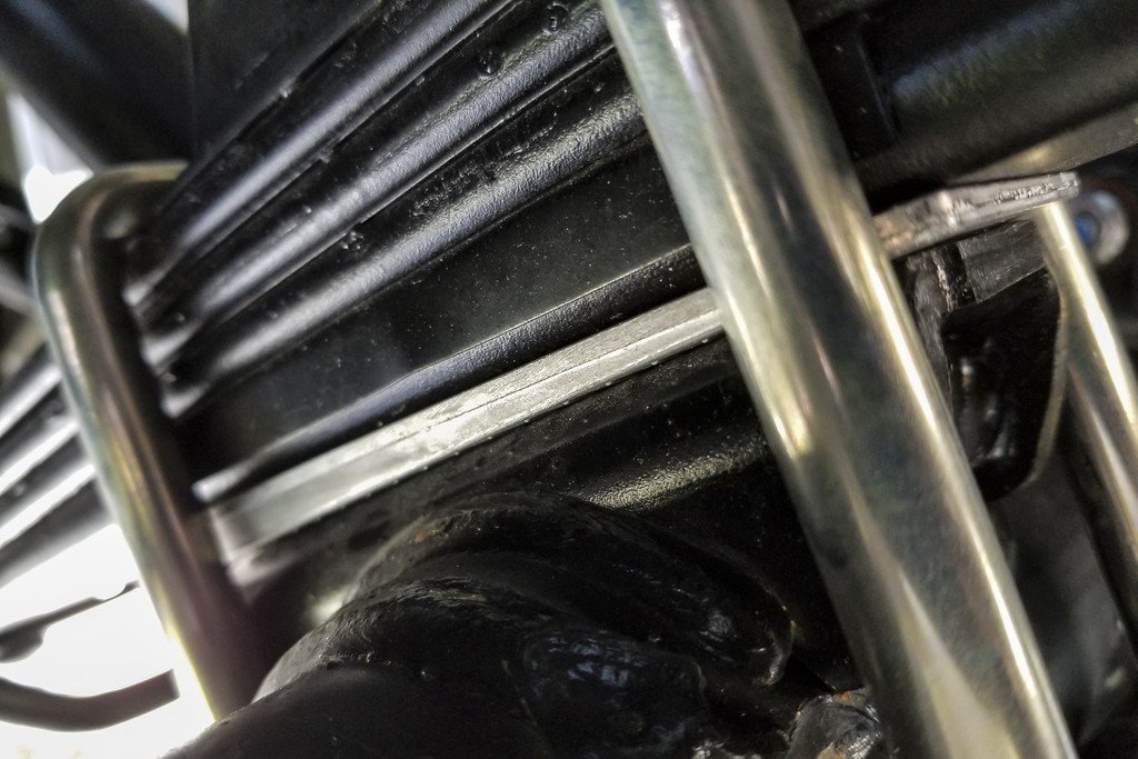

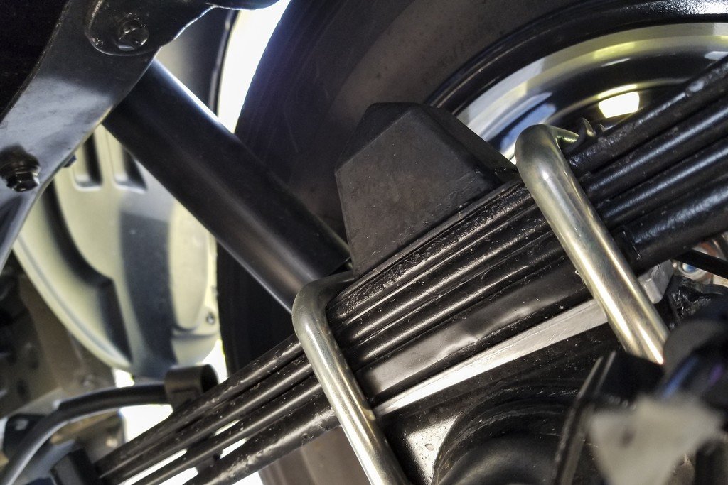

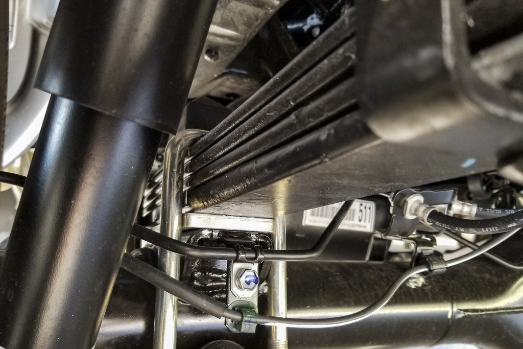

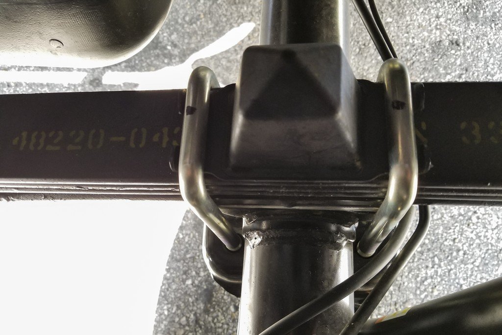

    I installed 2.5 Degree Axle Shims - Rancho RS8125 and fixed the vibrations! My all stock 2020 SR5 V6 4x2 DCSB truck drives smoother all together now! This did not require to remove the leaf bolt/pin and so it might not be recommend for hard core use since the leaf set pin is not set into the axle now. I torqued my U Bolt Nuts to ~57 foot pounds. I paint marked the brackets and u bolts to reinstall everything the best I could back into the exact same position as factory.

    Nice! Any chance of pictures of where you put them, etc?
    23psi4age[QUOTED] likes this.

    Yes pics please! If possible

    23 psi, are these leaf spring shimms ? Website shows them to be for springs and not carrier bearing?

    Yes leaf spring shims to correct axle pinion angle - I attached photos to my above post.

    So looks like from pic that shim is on bottom of leaf springs resting on top of axle. Looks like yours is like my axle with a flat spot on top of axle where leafs rests? Wonder could you drill hole in shim
    to let it rest in place like leaf spring?

    The shim comes with a big hole in the middle for the leaf spring centering pin to pass through.

    My bad I see.
