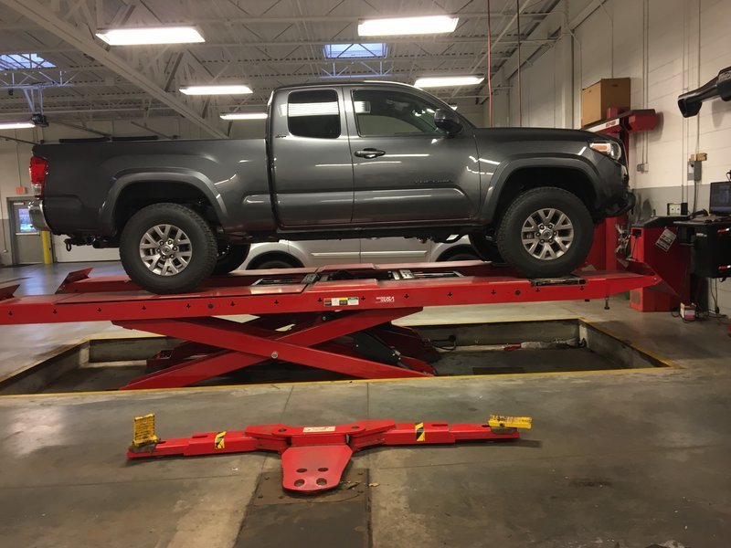

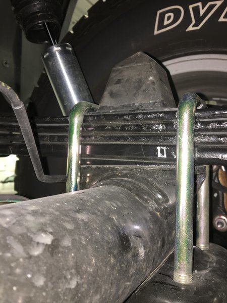

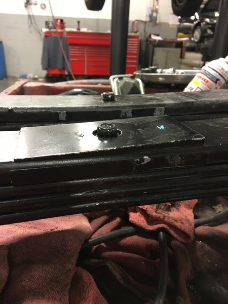

    New leafs add a shim to angle the rear axle, which changes the driveline angle.
    I'll update on the ride once I go home.

    Nice, I just looked and my leafs have a shim on my 2017.

    In between the axle and the leaf? I'll check mine out when I get off work

    Yes, same as Murray's picture.

    Anyone know the angle of the shim? Instead of going thru the headache with the dealer I might get a shim and put it in myself.

    Just like 10 years ago for horrible ride, toyota is now replacing non OR springs with OR springs.
    Rides good. I swear it accelerates smoother too, and I just didn't really notice the slight jitteriness until it was gone.
    Takes 2 hours. That's what they're going to tell you.
    In reality it took me 35 minutes for the springs, pictures, and steering wheel damper. (Yes, I did this. not only am I an internet toyota tech, I'm one in real life too). But since I just put my 5100's on last Sunday..I also did an alignment. So it was 45 minutes.
    Then I cleaned my interior and windows, because I have to pick up a lady this evening. So glad it doesn't ride like crap. haha

    Since you are a tech, what degree shim us that please?

    Sorry, didn't measure the angle of the shim. Also didn't get to do a before/after driveshaft angle measurement.

    The best way is to get an angle finder, and measure for yourself. Then you can make sure you get exactly what you need.
