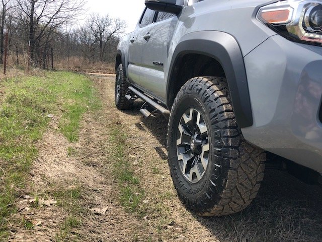

    84
    Gents, upgraded to the Nitto RG 265/75R16. Weighs 49 pounds. Greatly reduced or dampened the driveline noise. Leveling the front this week, will update.

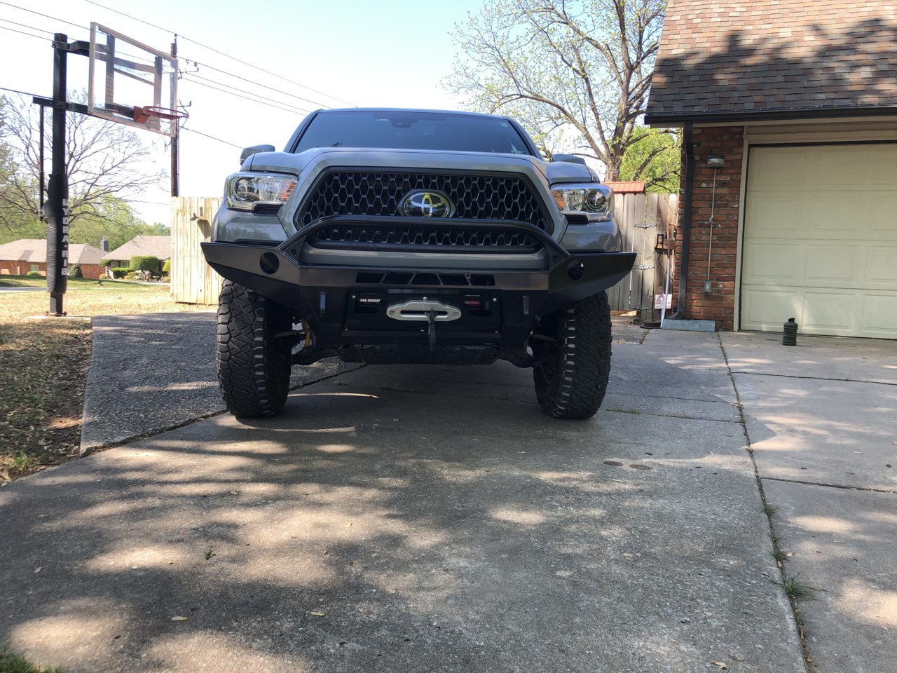

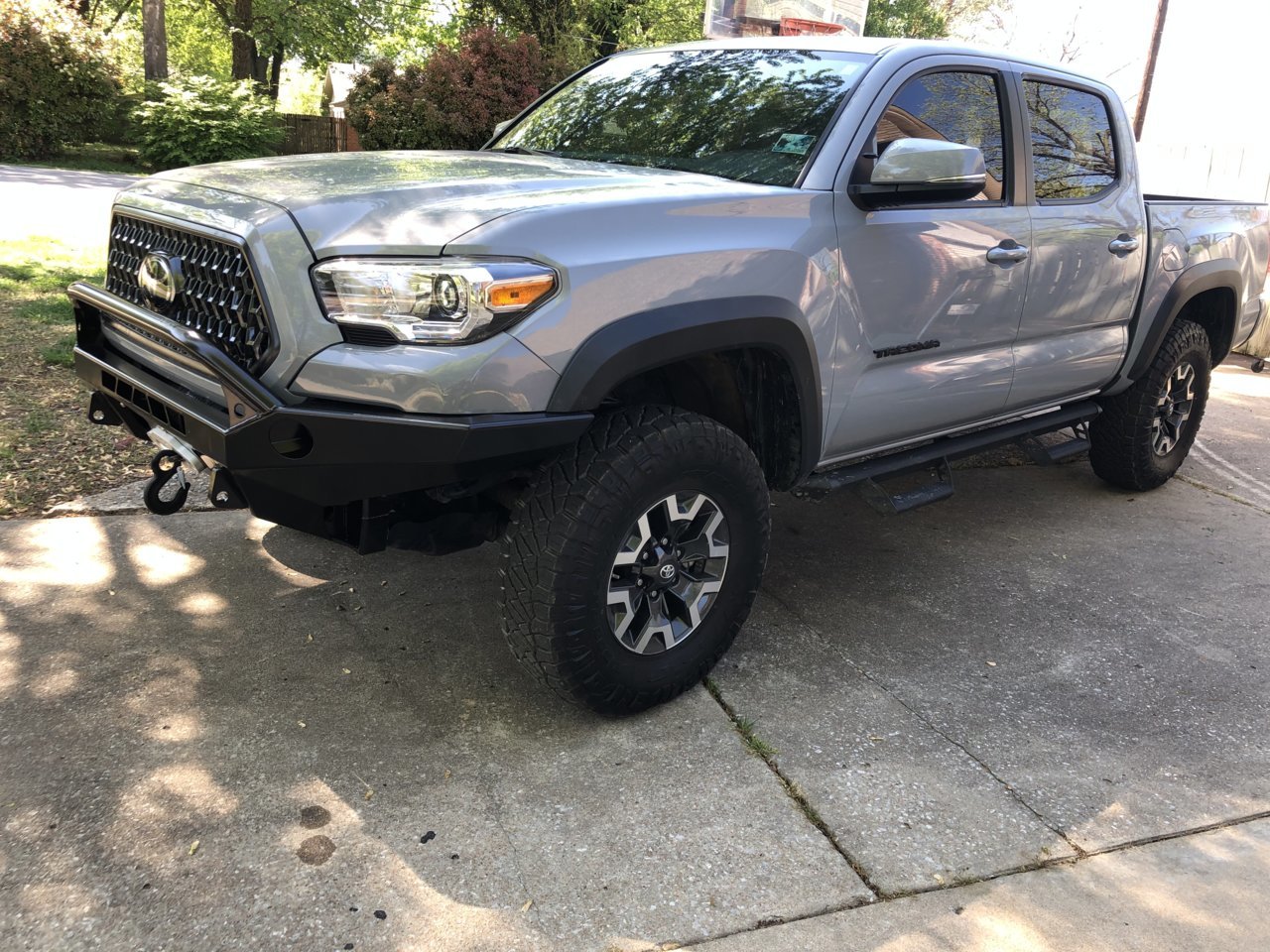

    84
    I recently made some upgrades to my 2018 Double Cab Off-Road that appear to have eliminated the driveline vibration (45-60 when feather gas pedal).
    First I upgraded to the Nitto Ridge Grappler 265/75 R16 which I understand weighs 49 pounds. This appeared to dampen (but not eliminate) the vibration. A few weeks later my steel CBIT3 bumper, Smittybuilt synthetic winch and OME (heavy spring and struts) were installed and the vibration/hum/noise is gone. I'm not sure what the lift amount was but the truck is basically level now. Good luck everyone.
