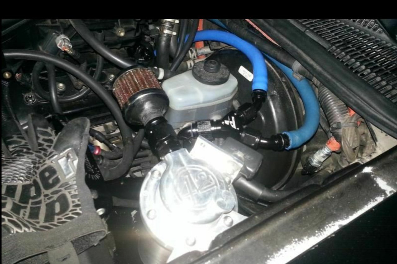

    So I am running the ripp supercharger catch can and I love it you can tell as to whether you are getting any trash in the blow by or not which to me being a technician for a boat company and working on so many engines it's a plus for me. There are alot of high performance boats that run them so I have had experience being able to see how they work. My last vehicle I had was an Audi A4 turbo swapped and tuned and had a catch can on it and worked out perfectly on it as well.
