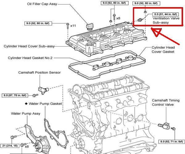

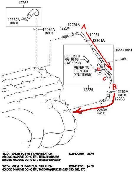

    I am also looking for info on adding a catch can to a 2tr. I found these diagrams on TW somewhere...
    So in the second image it seems pretty clear that the PCV (or what Toyota calls the "Ventilation Valve") is located on the back left of the valve cover as you look at the front of the engine.
    It follows from A through a rubber elbow, then through a metal pipe to B at another rubber elbow, then into the intake manifold. Pretty straight forward to add your can in the loop somewhere.
    My main question is the small pipe with outlets labeled C and D. Are these hooked to the PCV circuit or are they independent? I'm guessing that C and D make a tiny closed loop unto themselves and are not connected in any way to the PCV circuit. Anyone know for sure?

  9. Feb 22, 2015 at 6:11 PM
    vstrom
    vstrom Well-Known Member
    Dec 12, 2010
    #47569
    114
    Dammit.. I totally forgot about this.. And I'm not at home with the truck right now either.
    If I remember Ill take a pic this weekend.
    I just changed the oil last week too and dumped out the catch can.. it had a decent amount in it too after 8000km.
  10. Feb 22, 2015 at 6:17 PM
    vstrom
    Dec 12, 2010
    #47569
    114
    I just plumbed mine right from the PCV to the catch can then back to the pipe ('A' on your diagram). It didn't matter to me where any other feeder tubes go since I was catching the crap prior to getting that far downstream.

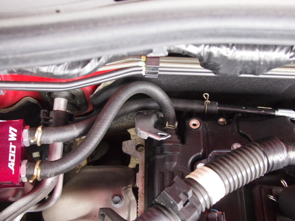

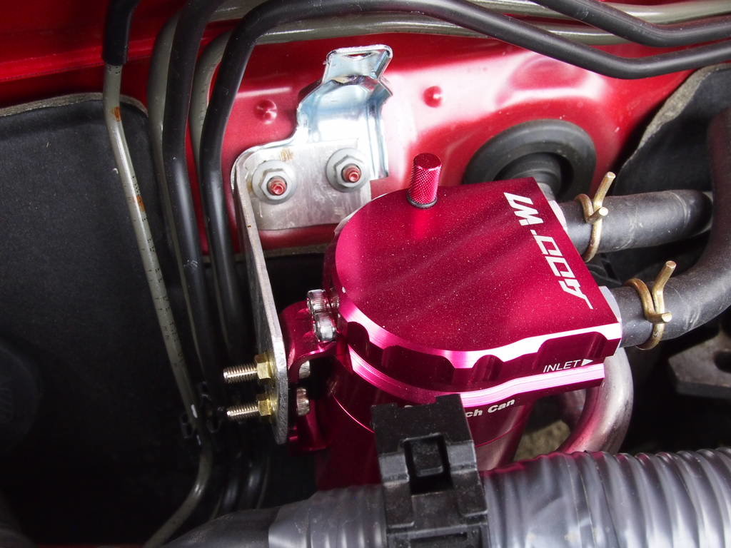

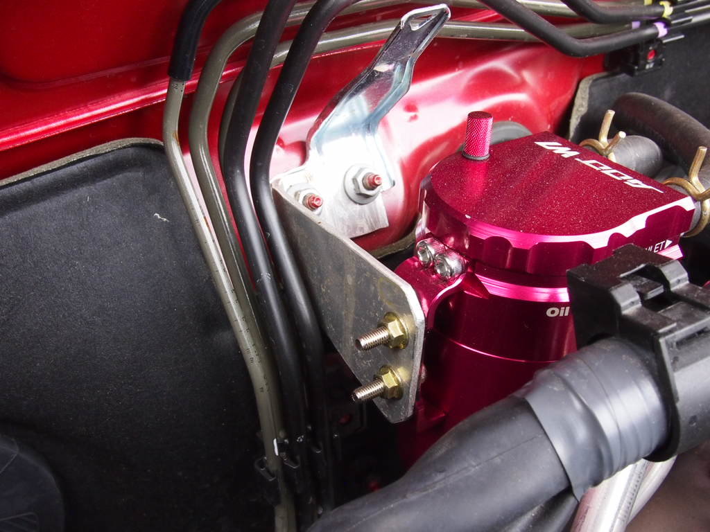

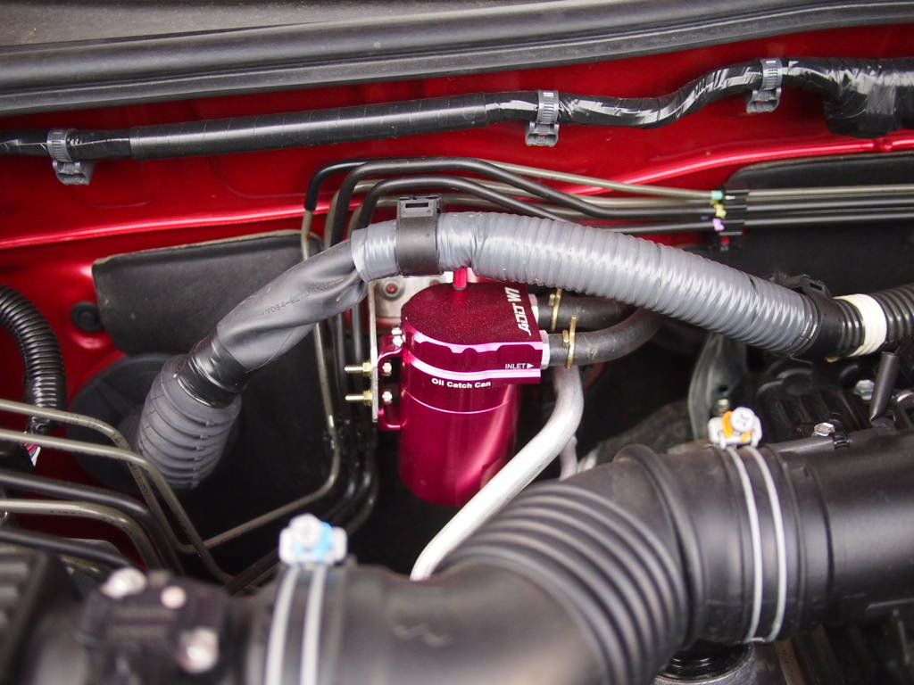

    Pictures of my install. I mounted an ADD W1 can on the passenger side fire wall. I made a simple bracket out of 1/8" aluminum and share mounting studs with a bracket that holds the large wiring loom near the fire wall.
    Views of bracket
    Pic of line routing. I originally planned to reuse the factory rubber elbow that is on the ventilation valve using a male/male barb to connect the elbow to a hose, but when I turned the elbow to point toward the passenger side it hit the wiring loom holding bracket, so I just went with hose all the way. I used 3/8" transmission oil cooler line from Advance Auto. Great fit on the 9mm barbs on the catch can.
    *Note: the big wiring loom is disconnected from the holder brackets only for the photo shoot.
