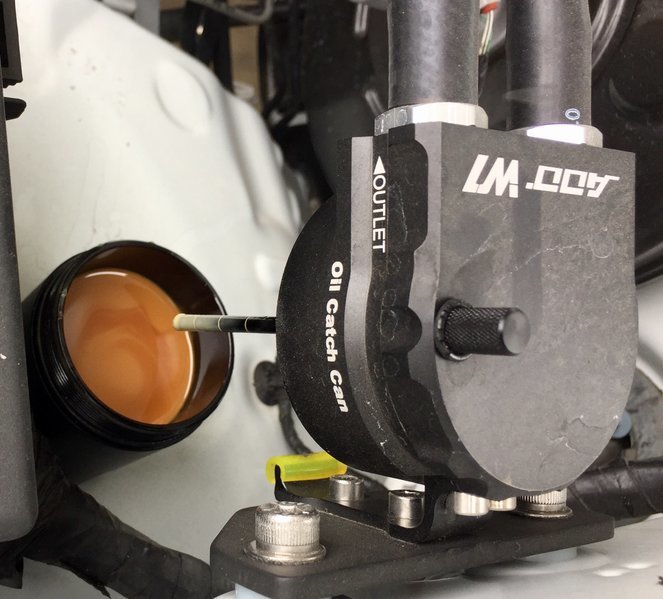

  11. Dec 22, 2016 at 8:44 AM
    #31
    sathump
    sathump Member
    Aug 7, 2016
    #193993
    17
    Just back from a 3k mile trip
    Mostly condensation
    2.7taco likes this.
  12. Dec 22, 2016 at 9:57 AM
    #32
    Mush Mouse
    Mush Mouse Club Soda Not Seals
    Apr 13, 2010
    #35188
    4,727
    mush
    where ever you want me to be
    2013 SR5
    its a Toyota truck and that's all the modifications needed
    that looks like a lot of fluid:eek:

  15. Jan 27, 2017 at 2:33 PM
    #35
    sathump
    sathump Member
    Aug 7, 2016
    #193993
    17
    Well I sold the truck but took this off beforehand, if someone wants to buy it.
    Like I stated before it was mostly water, which in the intake would not condense and simply go through the engine as vapor doing nothing.
    In my opinion the amount of oil is negligible and will also vaporize once the engine is at operating temp; and will burn completely through the combustion process. I personally don't ever see enough being able to collect in the runner. Also this enters post MAF
    About oil and 2 strokes and cats !
    2 strokes have high emissions because of incomplete scavenging, not incomplete combustion. That's why DI 2 strokes are some of the cleanest engines.
    The oil through the intake will never have a negative effect of the longevity of the cat on any modern engine; it'll combust.
    That said you could easily go dump a at qt engine oil in your full fuel tank and it won't change a thing, other than waste a qt oil.
    It will burn clean.
    In MX people mistakenly think the oil dripping off there silencer is from premix ratio; the reality is poor jetting. Wheather 60:1 or 16:1 the oil will burn completely if the (jetting) air fuel mixture is correct.
    ecoterragaia likes this.
