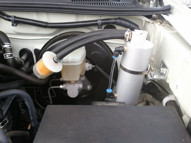

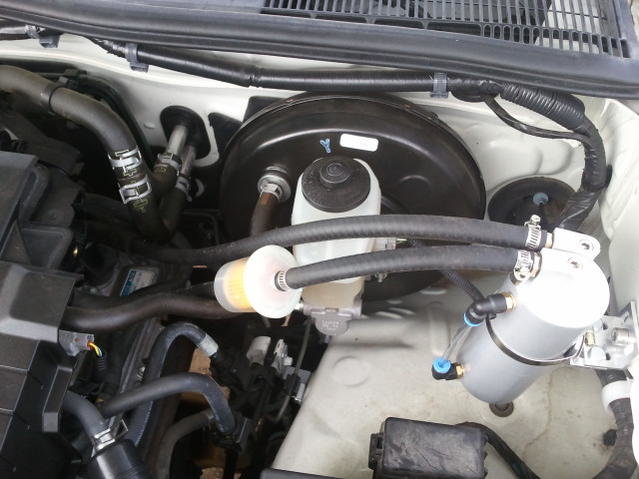

    I bought the 20 dollar catch can off ebay. it doesn't have a internal mesh inside. so I'm running an inline gas filter off the catch can going back to the motor. this way I can see if the can isn't doing its job. if it isn't ill up grade to the better on.
    first thing I did for this set up was tighten all the lines, bolts and what not on the can, cause they were all loose. bought fuel lines. I drilled a hole in the center of the bracket and mounted it on the driver side fender, there was already a threaded insert there. Reason i drilled a hole in the cneter was this way the brakcet wasnt attached only n one side, and it looks better this way. I popped off the old lines. cut the new fuel lines to size and clamped then down. I didn't take the engine cover off but did take that bracket everyone has said to remove to make it easier.

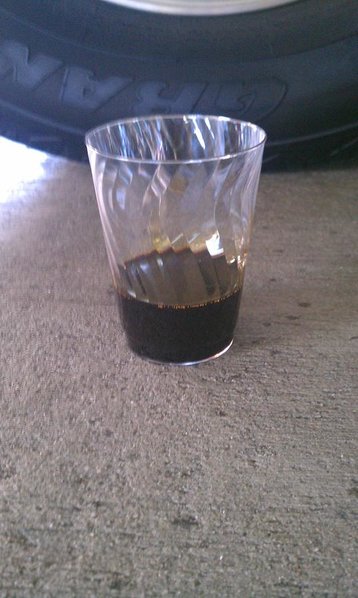

    Emptied mine today...
    This is about a month's worth of oil captured in the can...

    Damn, thanks for the pics! mileage estimate?

    11.6K

    wtf, you drive 11.6K miles on 1 month?:eek:

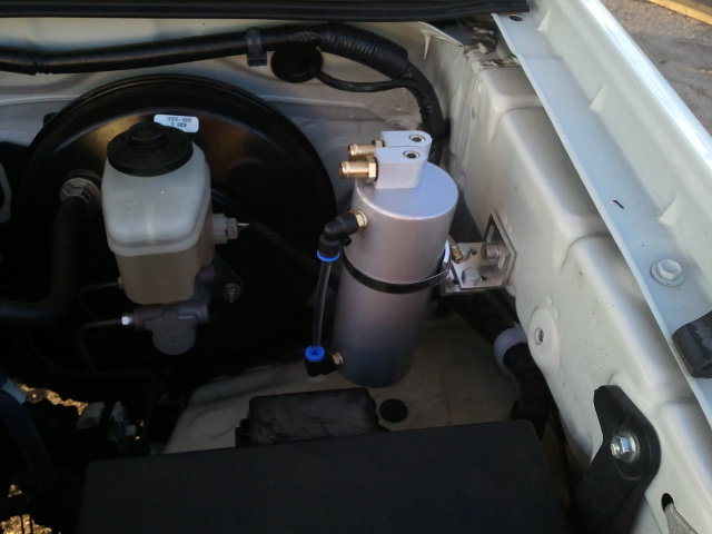

    Can anyone post a pict indicating where the catch can attaches to the engine on a 2012 v6?
    I think I know but just want to be sure before I install a can. Thanks.

    this is from the org poster.
    the new hose to the right shows where in goes on the engine. real easy

    yes :rolleyes:
    ~1400/month

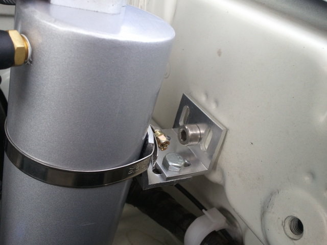

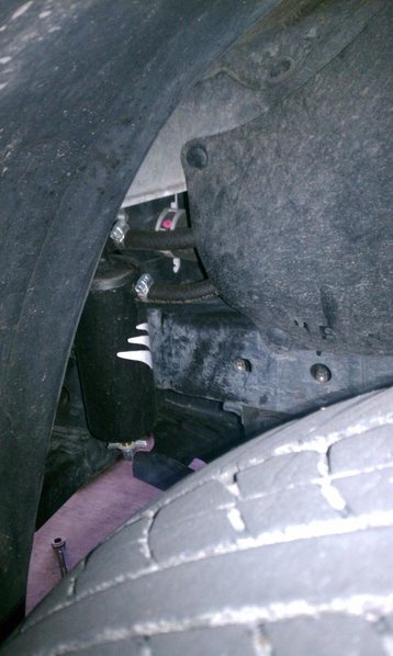

    First Oil Change after I installed the catch can. Got a decent amount of oil out of it. Attached are pictures of the location of the can and the amount of oil drained. Time was 4 months and distance was 5,025 miles.
