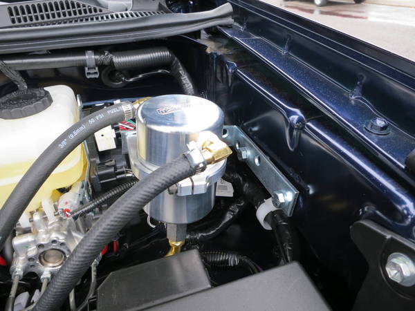

    Here's my Moroso oil catch can installed. A little spendy @ $140 from Amazon, but I think it's a good investment for the next 250+ thousand miles. Two metric M8-1.25 bolts fit the empty threaded holes on the side panel, and a 90 degree bracket with a couple of extra holes drilled to match up. The Moroso has fine wire mesh inside.

    Looks good, does the drain have a valve?

    Yes, the valve is obscured in the picture but it's on the back side of the piece sticking out from the bottom. Below that is a 90 degree bend tube for a drain hose, or I might just loosen the billet clamp and remove the canister to drain oil into a cup.

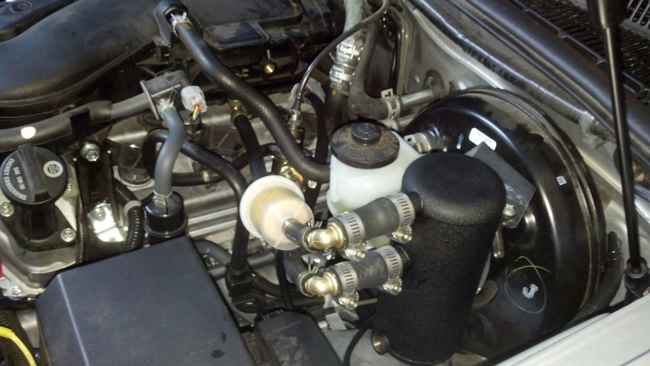

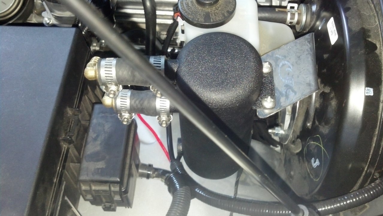

    Installed mine today

    Crom Super-Deluxe Member

    Looks great!

    Thanks, I still need to take my bracket off and paint it.

    Nice job! Is the bottom hole on the canister open?

    2018 Tundra CM TRD Sport
    Yeah, I didnt install the quick drain plug until after I took the pic

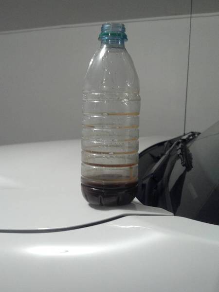

    Update:
    What I caught after 1000 miles.
    ~M
    Edit: Also I might add, for the past 1000 miles I have been running ethanol free gas. I found a gas station here that sells ethanol free gas :) Gas mileage went up, and I think i caught less oil than I would have with e10 gas.

    after 3,000 miles. there was about a teaspoon of water that came out first :notsure:
