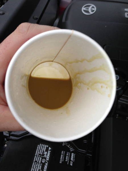

    Here's what I found after 600 miles. I installed the catch can when the truck had 300 miles on it. About the equivalent of the last gulp of coffee in a cup. I emptied it into a Starbucks cup and a few minutes later muscle memory and habit nearly made me drink it.

    Thanks, was having a senior moment. Damn Old Timer's. [​IMG]

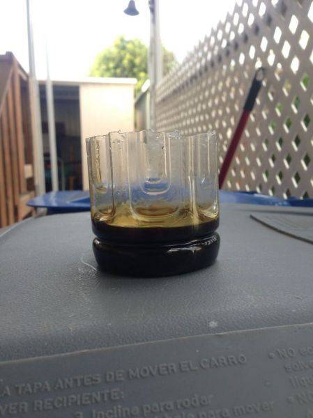

    anyone with results?
    2000 miles

    That is an impressive amount of oil, and to think it is being injected into your intake. Damn. Anyone remember the old Ford trucks with the hose just hanging under the truck smoking and dripping oil? I think Ford called it "Automatic Undercarriage Lubrication". :D

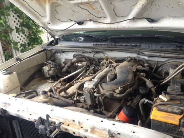

    CHRIS!!!!!
    you need to clean under your hood!!!!!
    snap son
