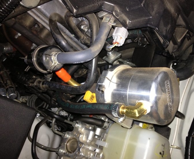

    Installed a Moroso 85481 using the provided hardware and an existing intake bolt.

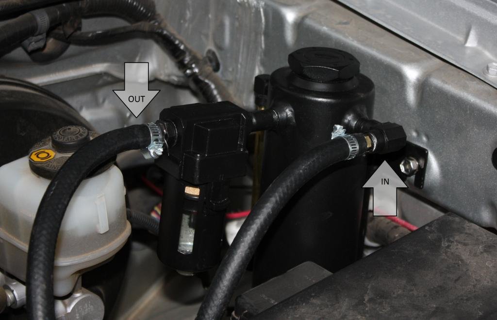

    ok cool. i wasnt hatin on you buddy. i have a 2nd air/oil spep as well but mine doesnt have any oil in it and my can doesnt have baffles in it. im gonna empty mine today cause im at like 1100+ miles

    i got my catch can off ebay. its really nice for 20 some odd bucks but it doesnt have a baffle inside. i also had to tighten all the fittings on it. search ebay, they also sell the nice one that splits in half and then you can add some mesh screenin inside
    mine looks like this, i added the fuel filter thinger and the fuel lines
