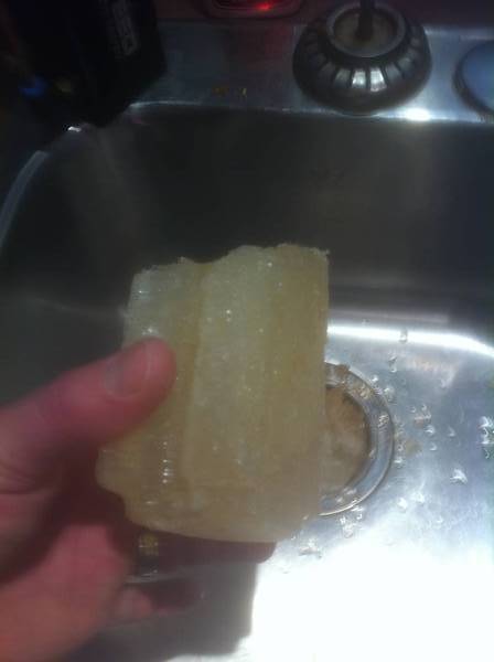

    I think think my fuel lines that I am using are not the problem, as nothing freezes in them, I took it out today and replaced with the regular line. I think even if I wrapped the can with something it is just a pain in the ass for me and another thing to remove when I empty the can. the Crawford Performace Can that someone linked is was to expensive to buy for 400$ wow.
    Thinking back about the water/ice in my catch can I think it is from the constant unfreezing while driving and then freezing with the condensation during winter, because previous times that I emptied the can before it became winter here there was just oil in there, about a cup or so.

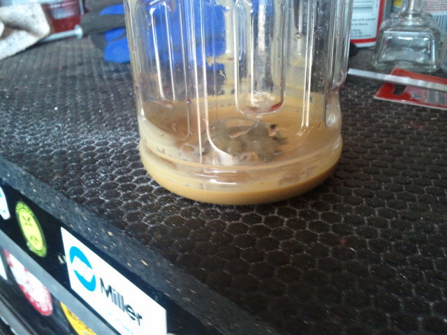

    SkeeterBilt
    SkeeterBilt Zombie
    Nov 5, 2012
    #90572
    312
    Skeeter
    Sierra Vista, AZ
    07 Prerunner DC LB TRD Zombie Response Team
    Black Satoshi Grill, Blacked Out Head Lights & Fog lights, Tint, Vent Visors, Shaved Emblems, Oil Catch Can, Ipod Hookup to Stock Head Unit, Sony Speakers, TRD Seat Covers, Xtra D-Rings and Other Small Things.... Lift and more to come

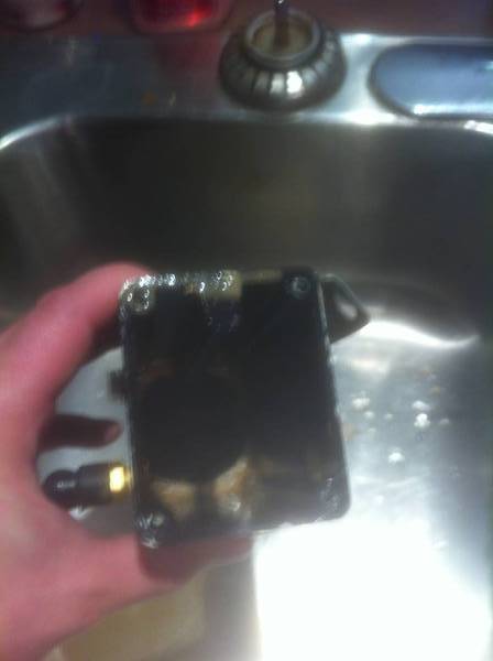

    this is what came out of my can..

    was given the braided lines, but he said they were 1/2" which were to big but just clamp down the hose clamps a little tighter and works perfectly. sorry for the late delay been busy.
    sweet. miles?
    frozen oil catch cans makes me glad i live in CA :D

    SkeeterBilt
    SkeeterBilt Zombie
    Nov 5, 2012
    #90572
    312
    Skeeter
    Sierra Vista, AZ
    thats about 1300+ miles

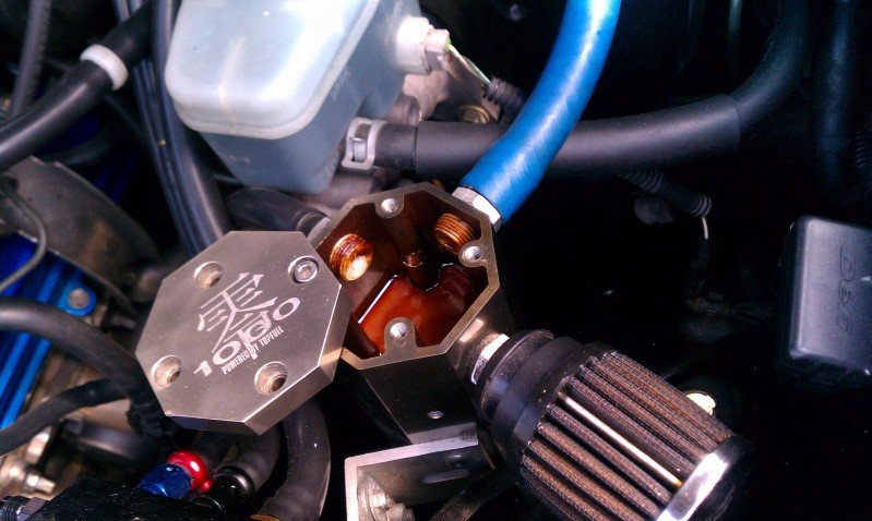

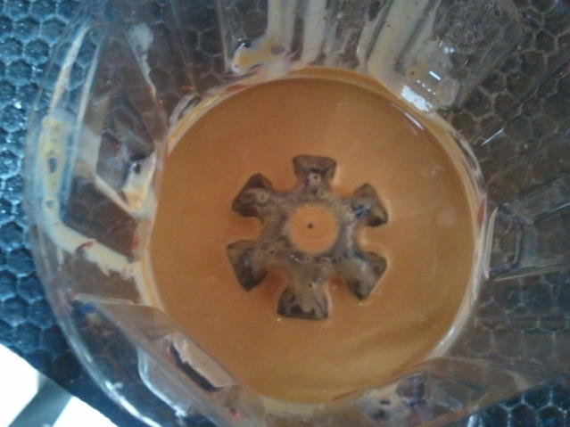

    Torspd
    Torspd Tor-nication
    Sep 18, 2009
    #22958
    26,299
    Tor
    The Great America!
    MMVI 4.4L 4x4 Access Cab
    Torspd Custom Turbo kit [] Borg Warner 9180EFR Turbo [] Haltech Elite 2500 [] TiAL Q BOV [] TiAL V44 Wastegate @ 15psi [] CP Pistons [] CP Carrillo Rods [] ARP Head studs [] ARP Main Studs [] ARP Header - Head Studs [] Ported Heads w/ 1mm oversized valves intake/exhaust [] Brian Crower Forged Stroker Crank [] Darton M.I.D. Sleeved Block [] Kelford Camshafts [] Torspd 160* T-stat mod [] APR Large Fuel Rail [] Walbro 460 LPH E85 Fuel Pump [] FueLab FPR [] APR T56 Conversion Kit [] KP RACING Built T56 [] McLeod Racing Custom Twin Disk Clutch [] One Piece Aluminum Driveshaft [] MGW Shifter [] Custom lowering kit [] Ohlins Front Coilovers [] QA1rear shocks [] Custom Ron Davis Radiator [] Dual SPAL Electric Fans []
    Here are mine to add. The super humid Houston weather makes for a very milky mixture. More so in the rare but cooler days.

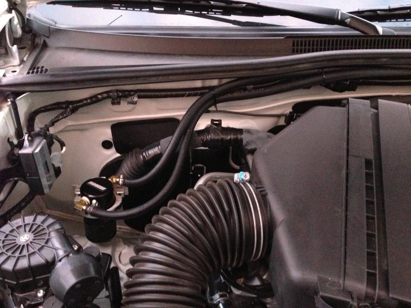

    05SuperChrg
    05SuperChrg Well-Known Member
    Feb 18, 2010
    #31649
    82
    SF Bay Area
    TRD Supercharger, TRD Air Filter,Rancho 9000's, Old Man,Fumoto Oil Drain Valve,Kenwood Sub, Sony HU,Wet Okole, debadged,satoshi,Slee Sliders
    Uplander can you post pics of your setup? I have a supercharger and would like to install a can but am having challenges where to put it.
    Thanks man

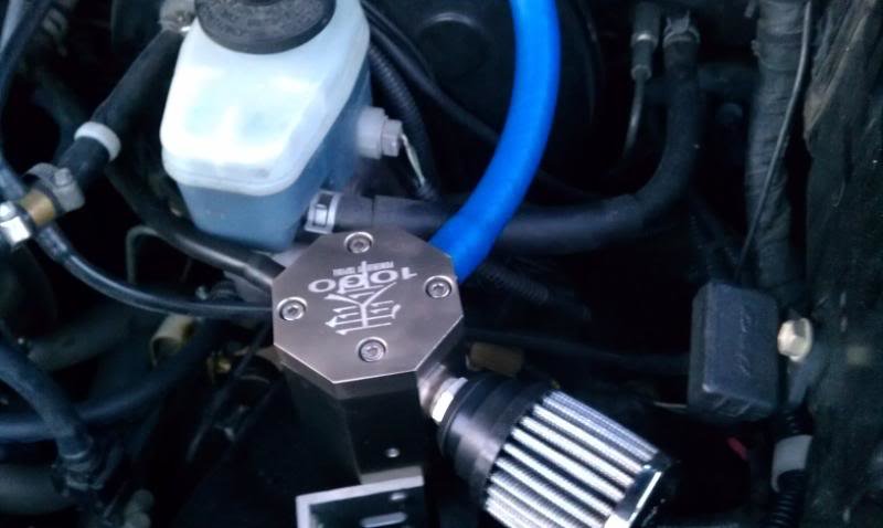

  14. Jan 13, 2013 at 10:24 AM
    #354
    Torspd
    Torspd Tor-nication
    Sep 18, 2009
    #22958
    26,299
    Tor
    The Great America!

    BUZZCUT
    BUZZCUT Well-Known Member
    Mar 6, 2011
    #52417
    777
    Georgia
    2021 TRD OFFROAD 4x4
    Why are you letting unmetered air into your engine? All air into the engine is metered through the maf. In your setup all the air isn't metered through the maf.
  16. Jan 13, 2013 at 11:31 AM
    #356
    Torspd
    Torspd Tor-nication
    Sep 18, 2009
    #22958
    26,299
    Tor
    The Great America!
    I was waiting for that question. ;)
    I'm not. You're looking at it backwards.
    Both valve covers vent on their own into the can. Then the gasses escape through the filter. The port on the upper plenum where the PCV hose is normally attached, is used by the EVAP solenoid now. The hose from just behind the throttle body, which used to feed that solenoid, now feed the vacuum block. :D
    I don't like that filter being right there though. Occasionally I can smell the gasses. So I will end up puting the filter on the driver side valve cover, then have a -10AN hose go from the passenger side valve cover, to the catch can, then to just after the filter, in front of the turbo. It will clean things up nicely.

    BUZZCUT
    Mar 6, 2011
    #52417
    777
    Georgia
    It still is unmetered. I knew you couldn't have that filter there in that manner. I figured you like driving it as it wouldn't run good if at all. here is an article with explains it fairly well.
    http://www.v6power.net/vb/showthread.php?t=35809
  18. Jan 13, 2013 at 12:06 PM
    #358
    Torspd
    Torspd Tor-nication
    Sep 18, 2009
    #22958
    26,299
    Tor
    The Great America!
    Mine is not unmetered because I have have completely removed the pcv system from the intake system. They are completely independent. In the pictures the open spaces of the valve train/timing cover area vent without any help from the intake system. And the intake system does not have any unmetered "leaks". Trust me.
    I appreciate the link, and while helpful for others, my engine setup is in now way like factory. ;)
    If it is more comforting, I went through various iterations until I properly routed my hoses so that I would not create a "leak". This way, the way I plan on doing it, or the way that I setup Toon714's are the only safe and effective ways to setup the PCV system, on our engines when running a boost setup that is pre throttle body. Otherwise two things can happen.
    1) You cause a vacuum leak a sensed by the ecu because extra unmetered air is getting into the egine which causes it to idle poorly and stumble badly. CEL's. And oscillating AFR's.
    2) You will pressurize the valve train/crank case area. Which causes leaks at the timing cover and valve seals, as well as reduced power.
    Trust me sir. My PCV hose setup is proper. :)

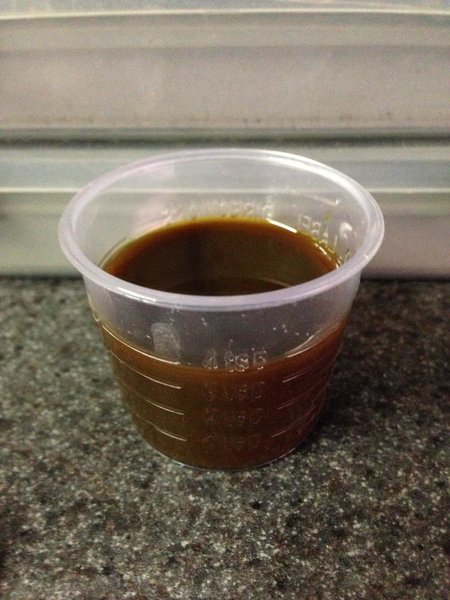

    SkullTaco2012
    SkullTaco2012 Well-Known Member
    Aug 19, 2012
    #85060
    108
    2012 DC TRD Off Road
    After installing my catch can and driving for about 650 miles I got about 4 teaspoons full of gunk out of it. See attached pictures...
