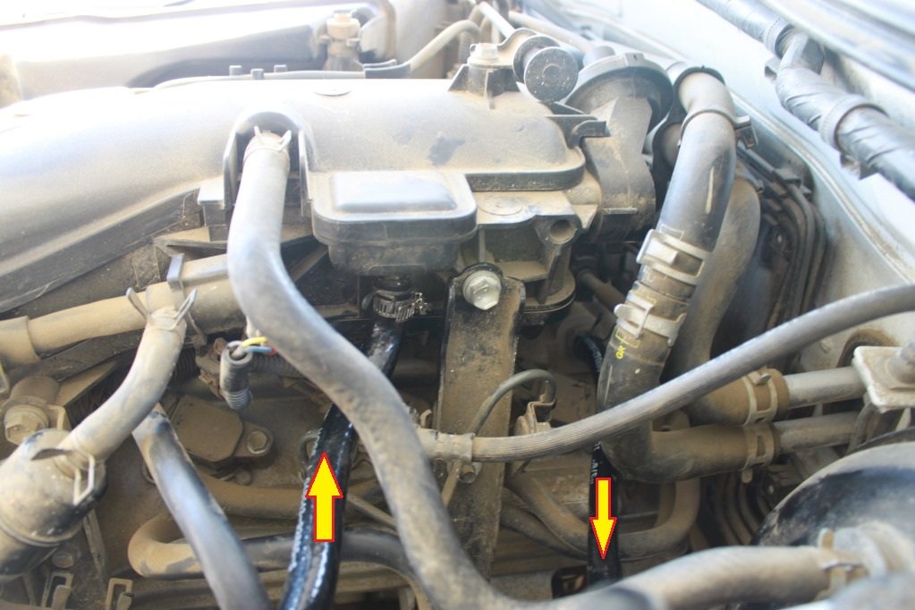

    I just want to be perfectly clear. The flow comes out of the horizontal fitting, rear of engine, right side of pic above-- flows in to catch can then back in to vertical fitting forward/left in pic, right?

    You got it

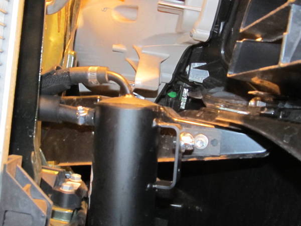

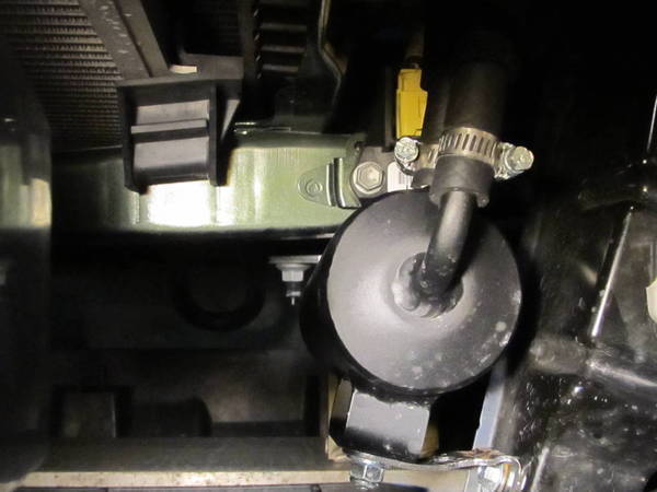

    Do you think this is too much of a lean?
    Instructions say mount it upright but this would be the best way for me if it won't affect it's performance.

    I don't think it's too much, you should be fine.
