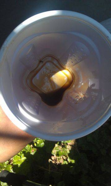

    well checked the catch can after my drive down south and back(500 miles) and there was oil.
    Dropped about half of the oil on accident but here is what i caught.

    Yeah i was stoked to see how much it caught after just 500-600 miles. Was like a table spoon, but i dropped half before i could take the picture.

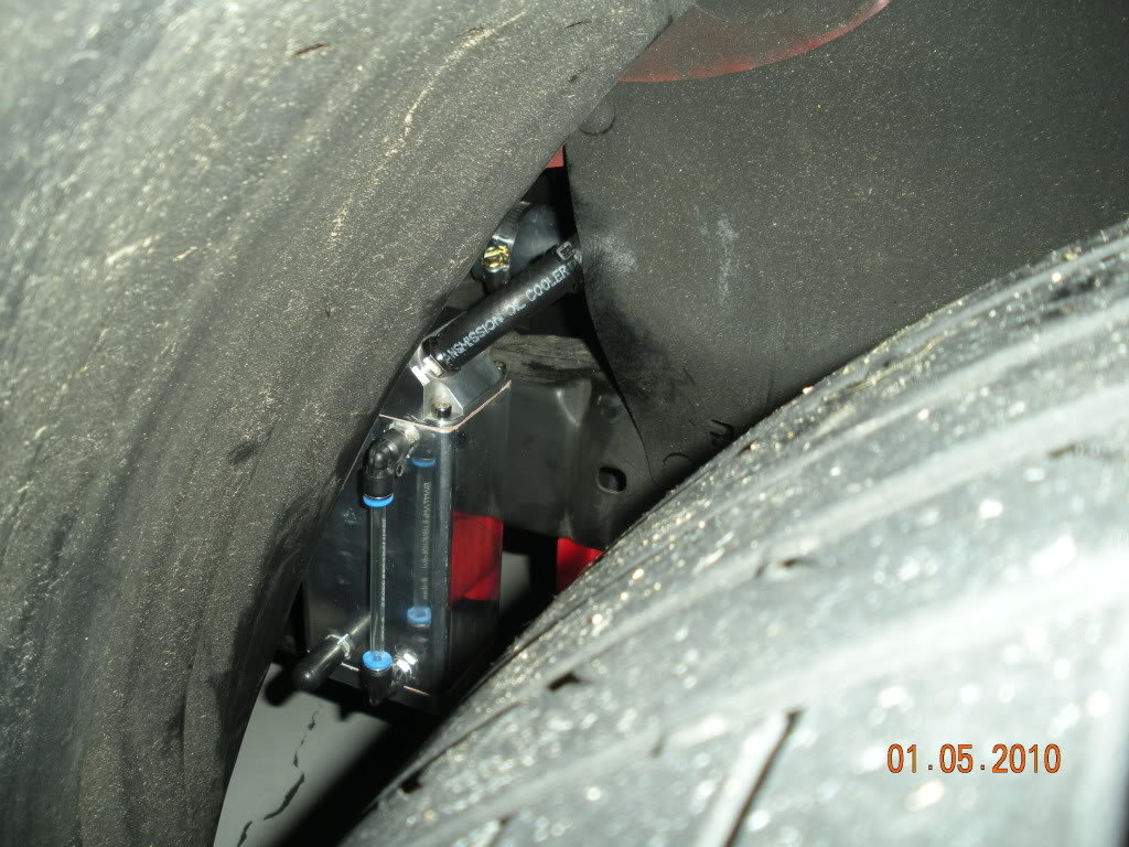

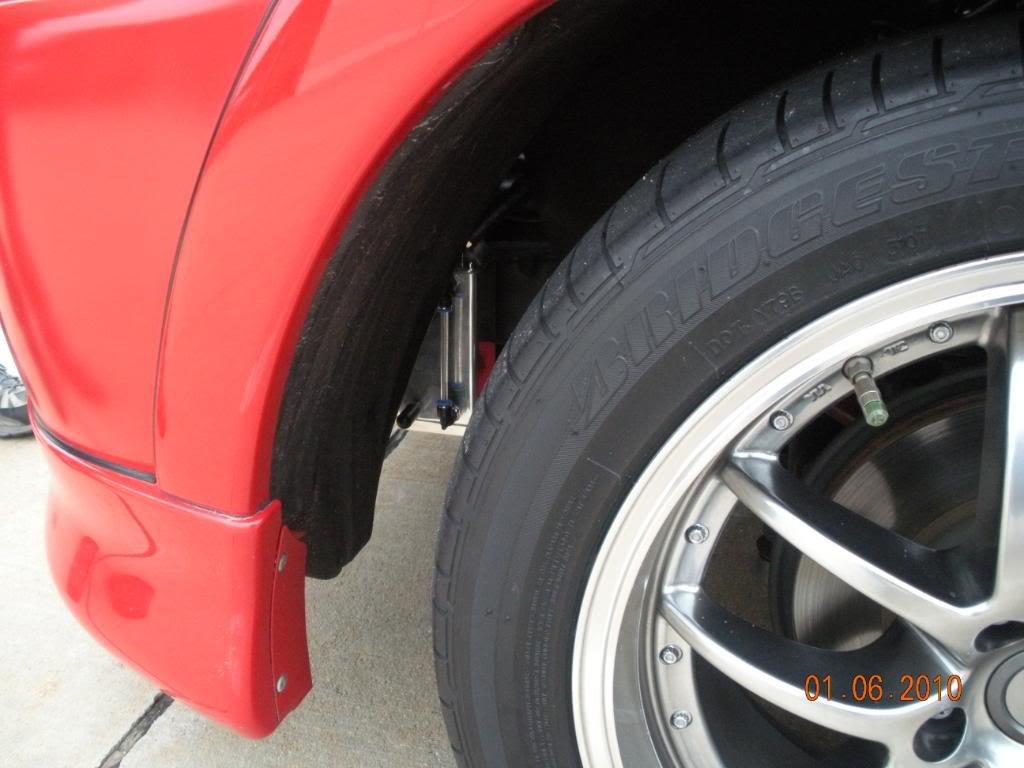

    I am S/C. I catch about a 1/2 cup at an oil change. I have my catch can on the driver's side frame rail, behind the bumper. This makes for an easy drain, when doing an oil change.
    nudavinci64, Bravisimo and Tex-Tac like this.

    1/2 cup? Those super chargers Are crazy.
    Just good benefits all the way around I guess!
    Pretty cheap item. Iirc its 25 bucks of flea bay

    I had emptied mine last week and wanted to track how much oil it would catch. This is what it had after 356 miles including a long 180 mile highway trip.

    I had something similar to that, before I spilled it and couldn't get a comparison shot. But yeah they catch a decent amount of oil
