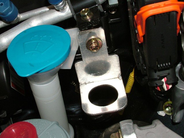

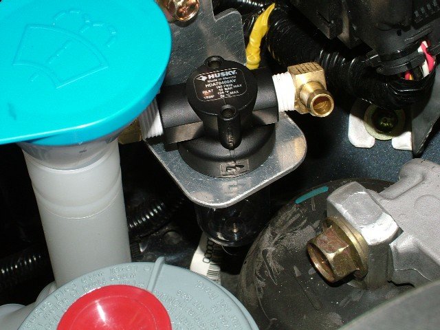

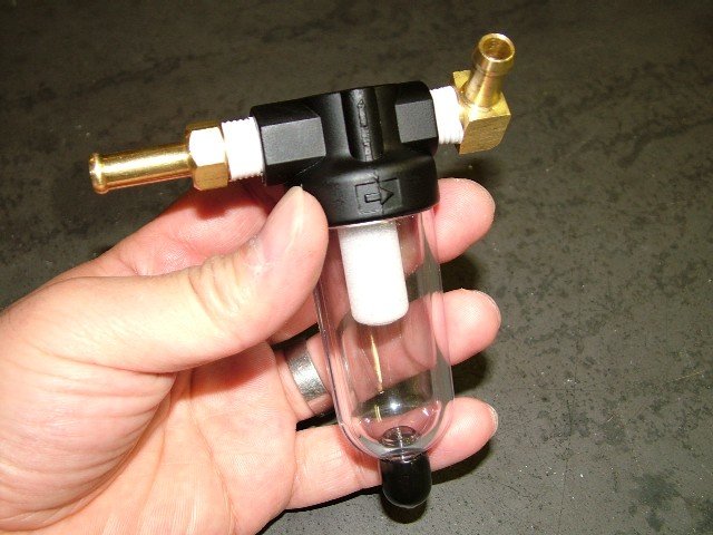

  13. Mar 4, 2013 at 6:20 AM
    #393
    mfdchief
    mfdchief Well-Known Member
    Feb 11, 2013
    #97295
    121
    Louis
    Rhode Island
    I was thinking of going with something like this. I found it on another site and pretty simple to build and most importantly to me is small. I have a plow and emergency lighting that's taking up most of the spots others have installed catch cans. figured since the truck is new now would be a good time to install this.
