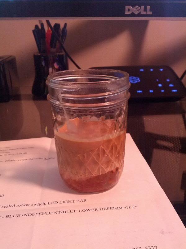

    Read a lot about this. so I ordered one based on what i saw from yellowrubiu.
    http://www.amazon.com/gp/product/B004K9BIY4/ref=oh_details_o03_s00_i00?ie=UTF8&psc=1
    Cost a good bit ($150) but it was really good quality and design.
    had to make a custom bracket to mount it but all in all it was really easy to install.
    After about a 2500 mile trip from East Texas to Colorado including driving up to the top of Pikes Peak.
    Since, I had to change my oil when i got back I went ahead and drained the can.
    :eek:
    Thumb is at the level.
    I was very very impressed with how it did!! and wow these things burn some oil!!
    Great Mod!! Love it!!

    Your engine loves you more. :D
    And yes, the PCV system does suck up a lot of oil. You are now saving the environment just a tad more too. ;)
    Looks good too.

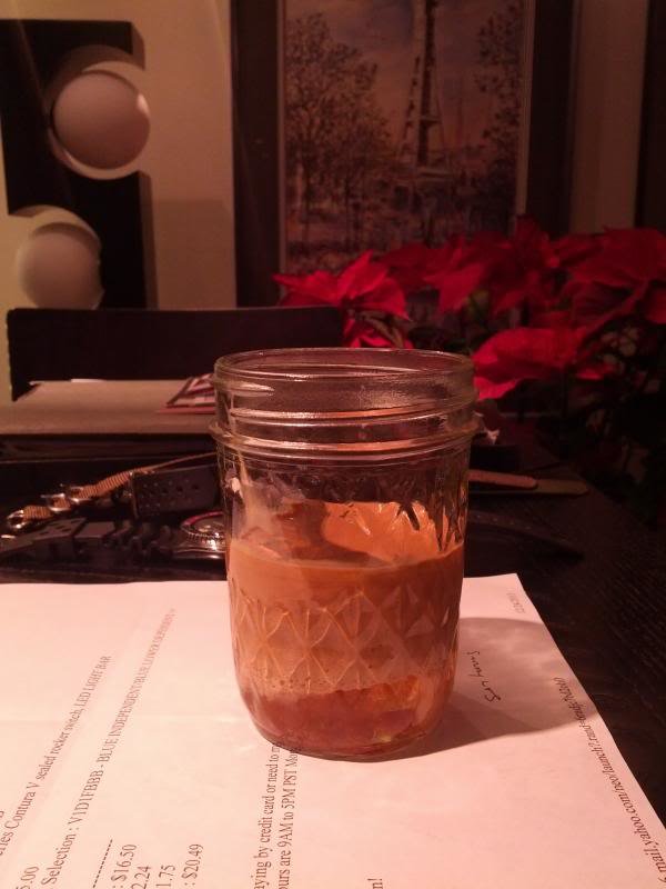

    1st drainage after about 4,000 miles. lots more water than i would expect. lots of short trips in the truck.
