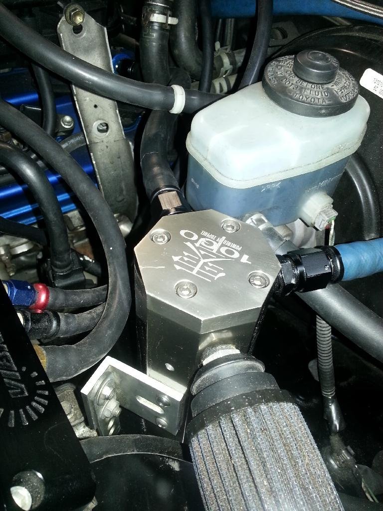

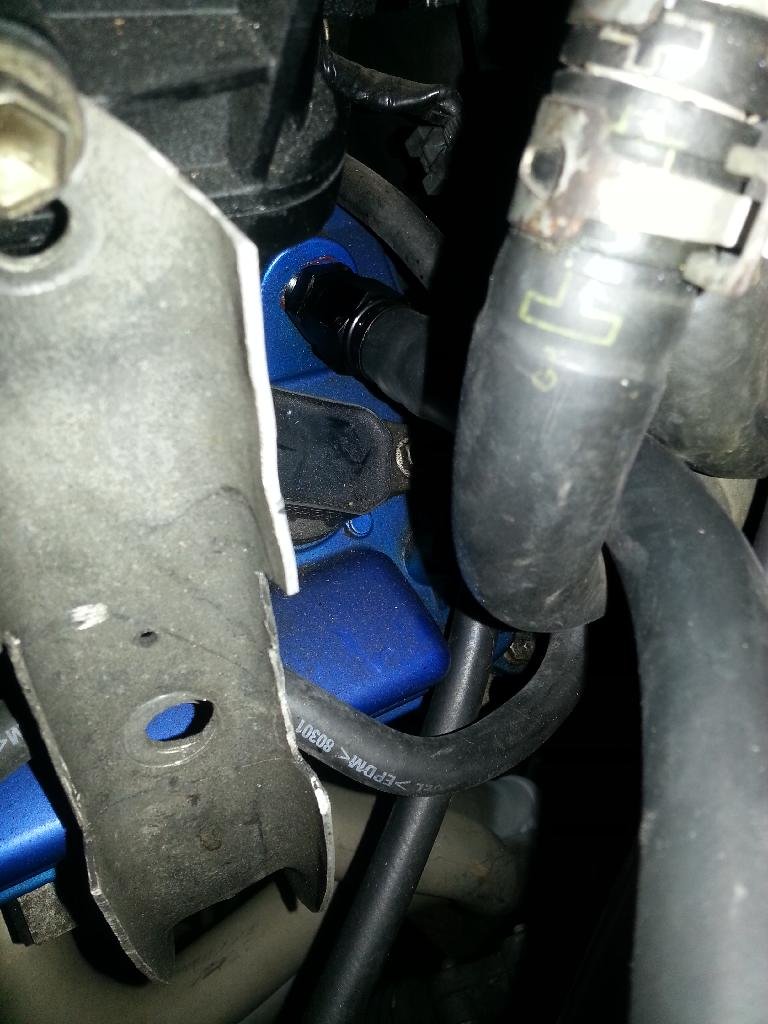

    Made some changes to my current can, as I still haven't installed the Draft42 can.
    Tapped the threads on the valve cover to fit 3/8" NPT. So that I could add a push lock -8AN fitting to it.
    Both sides are now -8AN inlets, with a breather outlet.

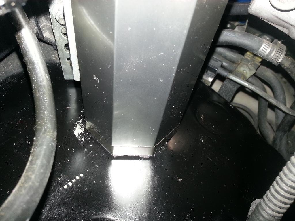

    To top it off, some foam padding for an isolation pad.
