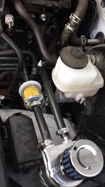

    Got it mounted and plumbed tonight. Only space I had available was on the passenger side if the radiator.
