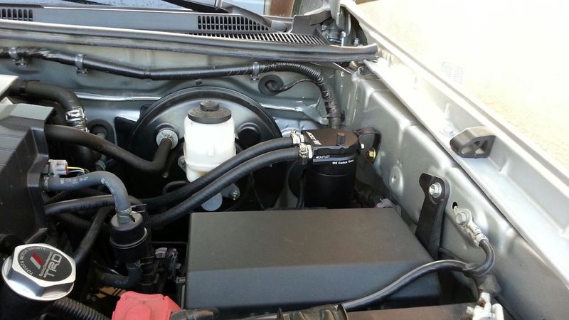

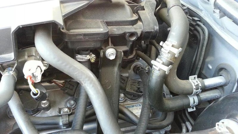

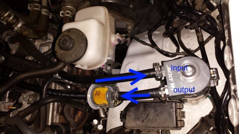

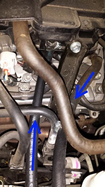

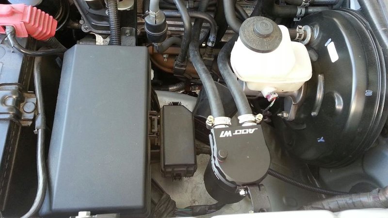

    3/8" is a perfect fit. The 7/16" is too loose on the engine side, where 3/8" is more snug fit. Here's mine:
