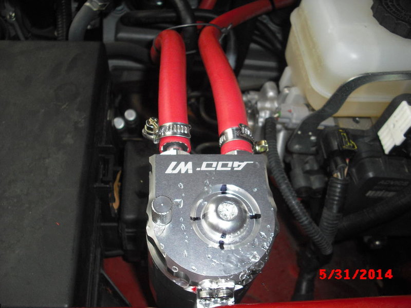

    I jumped on the bandwagon, this is just the first day:

    Couple of things: 1. Looks like you have the stock hose connected to the hose going into catch can. Do you? If so, I would remove stock hose and have just 1 hose.
    2. What is the filter in-line for? the oil will be collected in oil catch can.
    From experience, less connections is better.

    Same principle as the second gen. Find a spot where the pcv hose comes out of the valve train to the intake manifold. Just put it in-line with that.

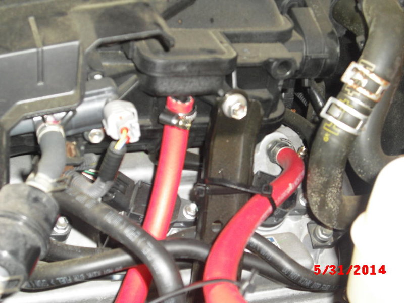

    Got my ADD W1 catch can. Going to try and get it installed this weekend.

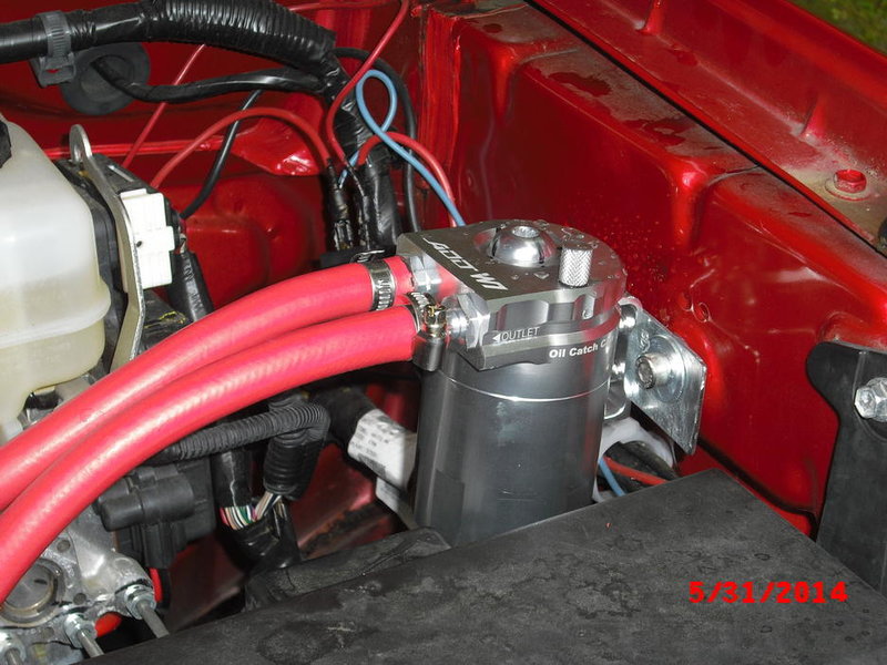

    Yeah, i just connected the existing hose to the new hose via a connector fitting. I initially did that so that the OEM hose could be connected back to the intake. However, I broke the fitting the other day intalling the new oil catch can/fuse block bracket.
    The filter was to catch any last minute particles. Saw one guy do it in this thread, and though that was cheap insurance after the oil catch can (it seemed to have turned a slight brown). However, since I broke the intake fitting, I had to unsintall it and now figure out how to build a new quick disconnect fitting on the intake.

    oil catch can #3.jpg Got my catch can installed. Had a fuel fliter as a sight glass. Had to remove it. Lights were on and the vacuum crushed the plastic filter. Works fine now[​IMG]

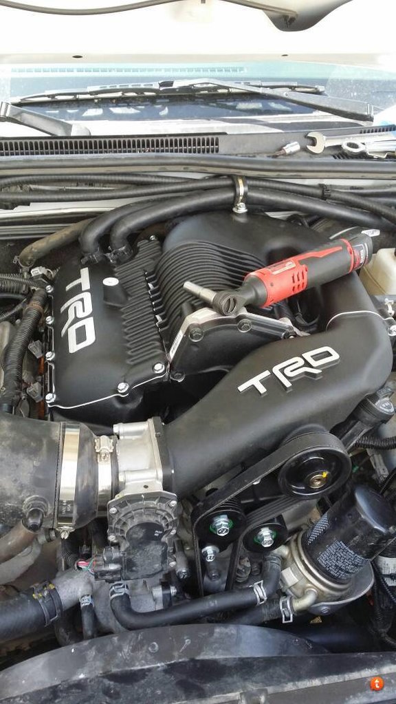

    How hard was it to get the PCV side off/on with the S/C'd hoses and brackets in the way...I can barely get my finger on the PCV...??!:notsure:

    It was a huge pita I ended up using those fuel line clamps they seemed easier to tighten with a small screw driver

    Think I'm just going to pop some hoses off, and take the manifold hose bracket off to access the PCV.....

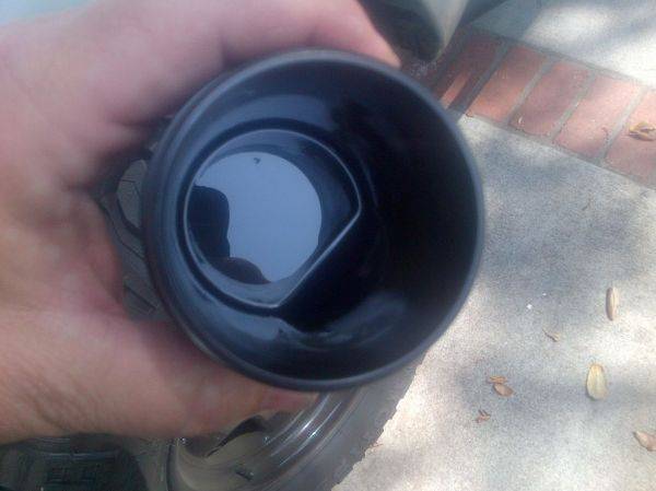

    i've noticed that some of you are collecting dark/dirty oil and some of you are collecting what looks like coffee with creamer in it. it that from being in a dusty climate like AZ?
  14. Jun 6, 2014 at 7:36 AM
    #534
    Torspd
    Torspd Tor-nication
    Sep 18, 2009
    #22958
    26,415
    Tor
    The Great America!
    MMVI 4.4L 4x4 Access Cab
    Torspd Custom Turbo kit [] Borg Warner 9180EFR Turbo [] Haltech Elite 2500 [] TiAL Q BOV [] TiAL V44 Wastegate @ 15psi [] CP Pistons [] CP Carrillo Rods [] ARP Head studs [] ARP Main Studs [] ARP Header - Head Studs [] Ported Heads w/ 1mm oversized valves intake/exhaust [] Brian Crower Forged Stroker Crank [] Darton M.I.D. Sleeved Block [] Kelford Camshafts [] Torspd 160* T-stat mod [] APR Large Fuel Rail [] Walbro 460 LPH E85 Fuel Pump [] FueLab FPR [] APR T56 Conversion Kit [] KP RACING Built T56 [] McLeod Racing Custom Twin Disk Clutch [] One Piece Aluminum Driveshaft [] MGW Shifter [] Custom lowering kit [] Ohlins Front Coilovers [] QA1rear shocks [] Custom Ron Davis Radiator [] Dual SPAL Electric Fans []
    Due to more moisture in the system.
  15. Jun 6, 2014 at 7:58 AM
    #535
    BradyT88
    BradyT88 Well-Known Member
    Nov 3, 2011
    #66419
    36,723
    Yep. When I drain mine the first little bit that comes out is straight water which is followed by the creamer. I assume if I let it sit for a couple days I would get water followed by dark oil.

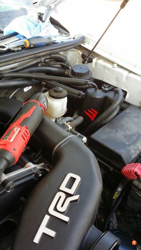

    Found a spot for the can...fabbed a 3/4"x1/8" piece of flat stock for bracket that still needs powder coated......
