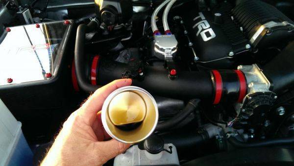

    Does it matter if the catch can has baffles in it or not? Why or why not?

    Baffles can be used to hold a Media(stainless steel mesh in my case) that the blow-by vapors and gasses "collect on and drip into the canister for later disposal...Helpful in the forced-induction world, but N/A engines benefit as well...here is basically what the Catch Can does....
    An oil catch can is used in turbo applications, or high-performance race applications where excessive blow-by (leakage past the piston rings) of air and fuel vapor occurs. This creates a positive pressure in the crankcase. Engine manufactures have placed a valve on the engine block which releases this pressure. This valve is known as a PCV (Positive Crankcase Ventilation) valve. During engine operation, blow-by gases, as well as oil mist from the rotating components of the engine, pass through the PCV valve and are routed back into the intake for the engine to burn off. However, some of the oil mist and other products settle along the engine intake and over time form a "gunk." The oil catch can collects the oil mist and condenses the fuel vapors while allowing "cleaner" gases to be passed back into the intake. Typically the blow-by gasses are passed through a wire mesh, which give the vapor droplets something to adhere to. Since the oil catch cans condense the vapor portion of the gasses, they will need to be drained periodically of all the oil, fuel and other contaminants.

    So if what if I put some steel wool in there or something like that to help catch or collect the vapor? Would that be the same thing? I could always get some flat stock and drill a bunch of holes in (or Kydex) and then epoxy it in there...

    NOT steel wool, you will end up with fibers in your system.

    Stainless Steel Pot Scrubber

    Ok, thanks for the tip...pot scrubber it is...

    +1 on the SS pot scrubber.

    That's what I use in my catch can. It doesn't take a lot either :thumbsup:
