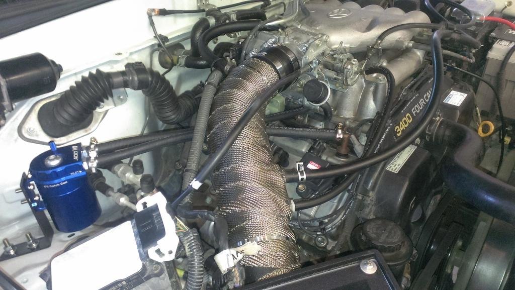

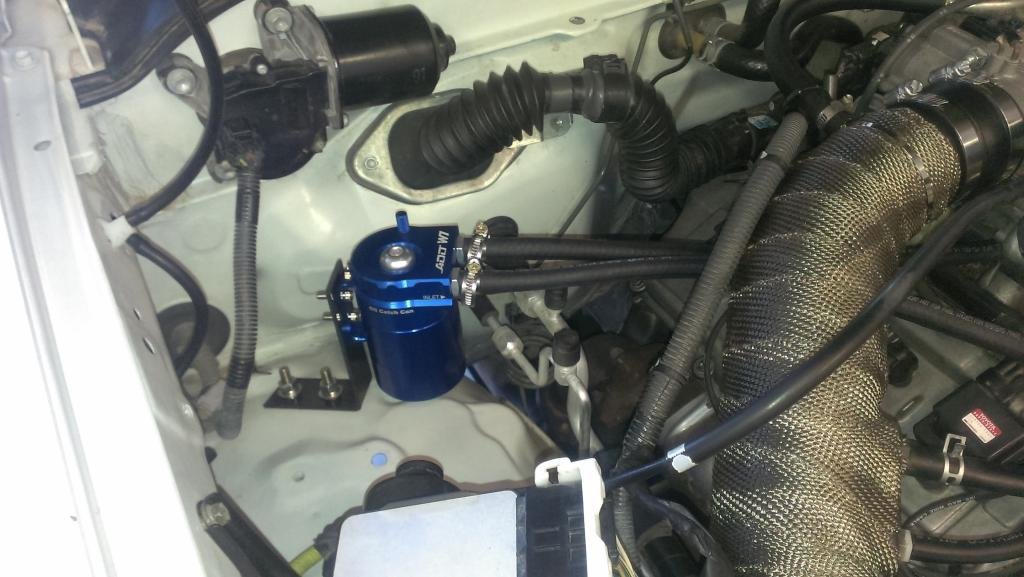

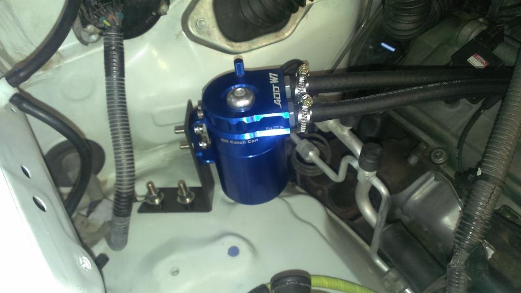

    Did this over the weekend...
    I won't need to add the pot scubber, the inlet already had a multi baffle set up.

    Have you got your hoses crossed? Should go from PCV to inlet side.

    It is, but because of the position, it's hard to see the hose. I have it running from PCV valve to inlet, then outlet to air intake plenum.

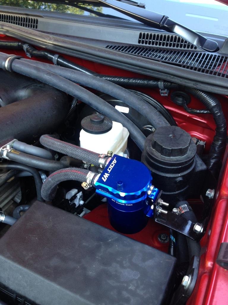

    Finally got around to throwing my can on.... what a pain it was to get to the pcv on my blown 14 need some baby hands to get in there haha 4c294fcf-0dd3-4e1a-b0f5-0089393d41e9_zps_b47eb13d361377d8f4d5e85d2e9976c8402c8f51.jpg

    I know the feeling. I had to use a 1/4" drive long extension with a universal joint (or whatever you call them) to tighten the hose clamp. PITA.

    BTW, it looks really nice! Sweet install :)
