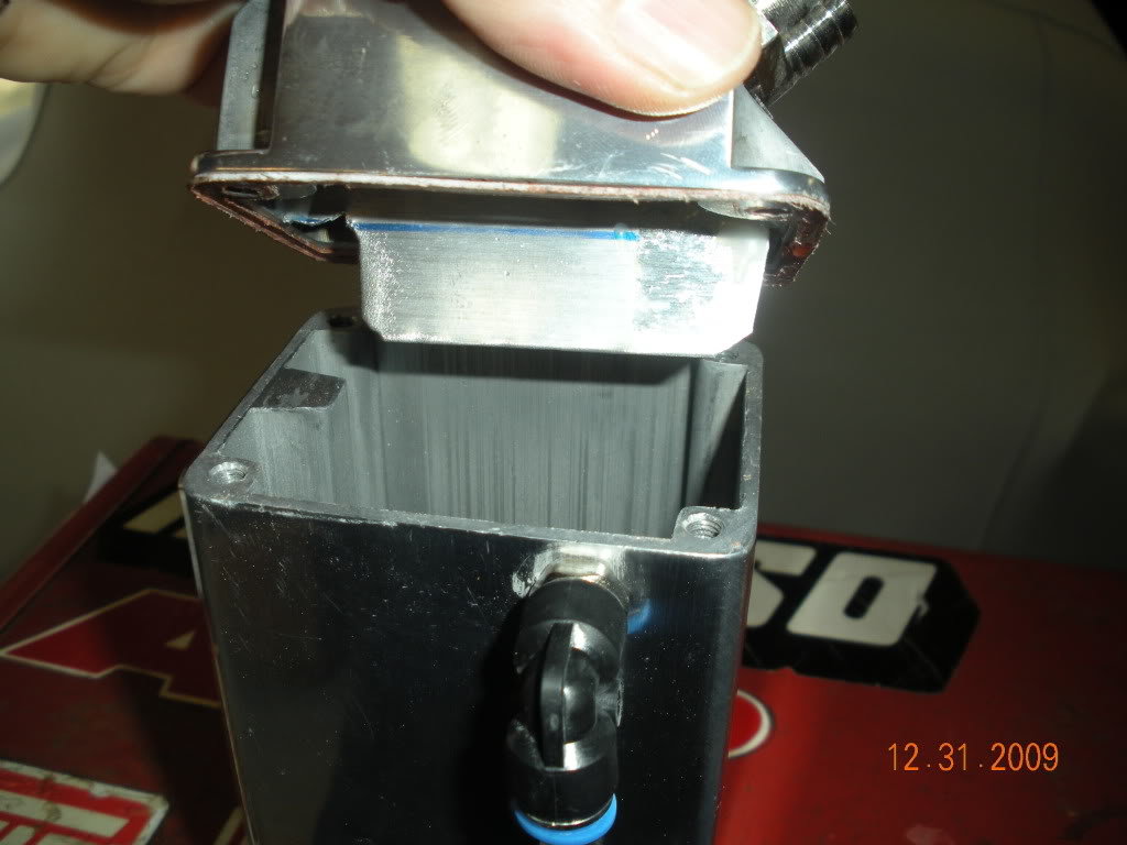

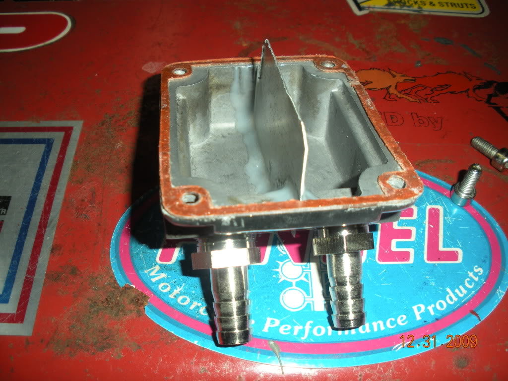

    Hey ran across this picture. super085_de6169be7be64865a0c69a90b5d9872cf588ae53.jpg
    I think its Coupe's ^^

    That is mine. I made the baffle and epoxied into place,

    is that all you run in there? no catching media

    No media. I did not want any media finding a home inside my engine or s/c.

    Good point, think I'm going to make a baffle for mine.
    thanks. its useful too
