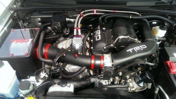

    You installed this on a TRD SC taco? Any chance you have more pics to show routing of your hoses? :)

    NY
    14 BR AC
    I do not have anymore pics i could try to snap a few if i can remember but i just ran one hose from pcv and the other off the intake of the blower. I didn't have to do any fancy routing of the hoses to the location of the can. Honestly the hardest part was finding a good spot to mount the can....not a whole lot of real estate on a 6spd 14.

    #595
    AWF ROWD
    AWF ROWD ...eats at the " Y " often....
    Feb 14, 2013
    #97497
    2,890
    Doc
    40.102° N, 82.804° W
    '13 BLOWN 4X4 Sport
    TRD Supercharger, Walbro 255 FP Upgrade, aFe Stage 2 si CAI, TRD Acrylic cover by Coupe ADD 1 OIL Catch can/SS hoses, TRD cat back exhaust, URD 2.8" Stealth pulley, 3" lift, Toytec/Bilstein C/O's, Toytec Progressive AAL's, LR UCA's, 5100 Rear Billies, Bi-Xenon HID BHLM Retro's w/ Halos RED LINE Tuning Hood Rods Swaybar Relocate, Line X'd Bull Guard/Step, Hitch, Craven Speed Dual Gauge mount, AEM Boost/AFR Gauges, Windows 20% tint, Weather Tech deflectors, GrillCraft upper and lower, Tacoma Raptor letters, LED Interior/Exterior lighting, Lund 6" Color Matched Oval Side Bars, Webasto 700 II sunroof, Heated Two toned custom leather TRD logo'd, Kenwood Multimedia 6990 HD head unit ,JL Stealthbox sub, Hertz Component speakers,, Entire cab damped with hushmat, Viper Security/Remote start, Weather Tech Liners, Blackened exterior LED Lights, Undercover Top w/LED's, Carbon fiber TRD windshield decal,, TRD stitched leather shift knob, TRD steering wheel emblem,
    Yes..!
    Havent had any issues, best to just check can once a month..!
    My 3/8" fit perfectly...snug but not difficult to install/remove..:cool:

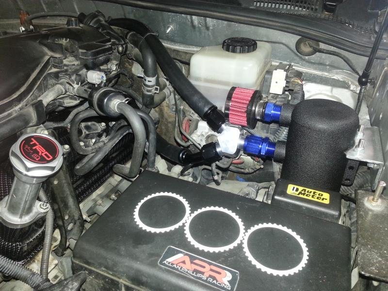

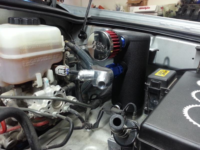

    Mine:
    Lucario Runner's :

    Is there a pcv valve on the passenger side I should be filtering?
  18. Mar 7, 2015 at 2:21 PM
    #598
    Torspd
    Torspd Tor-nication
    Sep 18, 2009
    #22958
    26,300
    Tor
    The Great America!
    MMVI 4.4L 4x4 Access Cab
    Torspd Custom Turbo kit [] Borg Warner 9180EFR Turbo [] Haltech Elite 2500 [] TiAL Q BOV [] TiAL V44 Wastegate @ 15psi [] CP Pistons [] CP Carrillo Rods [] ARP Head studs [] ARP Main Studs [] ARP Header - Head Studs [] Ported Heads w/ 1mm oversized valves intake/exhaust [] Brian Crower Forged Stroker Crank [] Darton M.I.D. Sleeved Block [] Kelford Camshafts [] Torspd 160* T-stat mod [] APR Large Fuel Rail [] Walbro 460 LPH E85 Fuel Pump [] FueLab FPR [] APR T56 Conversion Kit [] KP RACING Built T56 [] McLeod Racing Custom Twin Disk Clutch [] One Piece Aluminum Driveshaft [] MGW Shifter [] Custom lowering kit [] Ohlins Front Coilovers [] QA1rear shocks [] Custom Ron Davis Radiator [] Dual SPAL Electric Fans []
    Negative. Ours are both setup to vent to atmosphere. On his N/A engine, his port on his intake is capped, as well as on the intake manifold. Therefore both valve covers vent on their own, into the can, without aid from circulating air from the intake and manifold.
    The PCV system on our setups is completely independant of the intake.
