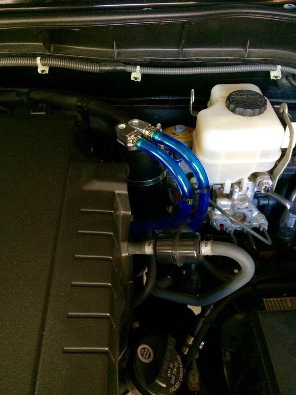

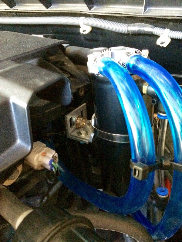

    Good point. I could probably easily lower this more if need be. I dont want to be close to the headers though.
    Decided to throw one in the FJ. Am posting because Tacomas look to have the same metal engine to intake bracket. Works pretty well as a mount for the can since it is literally right there by the lines. I just used a slightly longer bolt and drilled a central hole in the provided catch can bracket
    I need to replace these silly blue ones with some real hose but I am getting no line flattening so far. Pleased for one of these cheapy eBay ones. Edit: I went on a 500mi trip the day after install and it was whistling when warmed up. Replaced said silly blue lines with 3/8" fuel hose and all is well

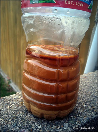

    5-Months worth of shit in my can.
    :puke:

    With the condensation here in the mornings, my can fills up in about a week! With water of course.
    Five months isn't bad for it to look like that though. Especially considering the weather.

    Thanks Tor. I moved my can a few years ago down inside the bumper, since doing that it does collect a lot more water than when it was in the engine bay. Either way I'm happy with the results. :thumbsup:
