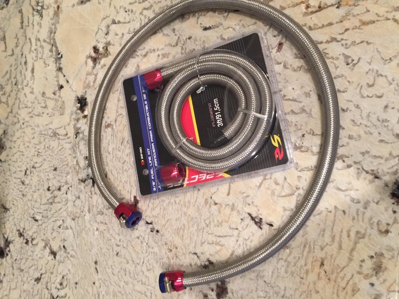

    Well I f'd up... Guess I will look at braided stainless line.

    Got this from Amazon but still waiting on my can. :pout:

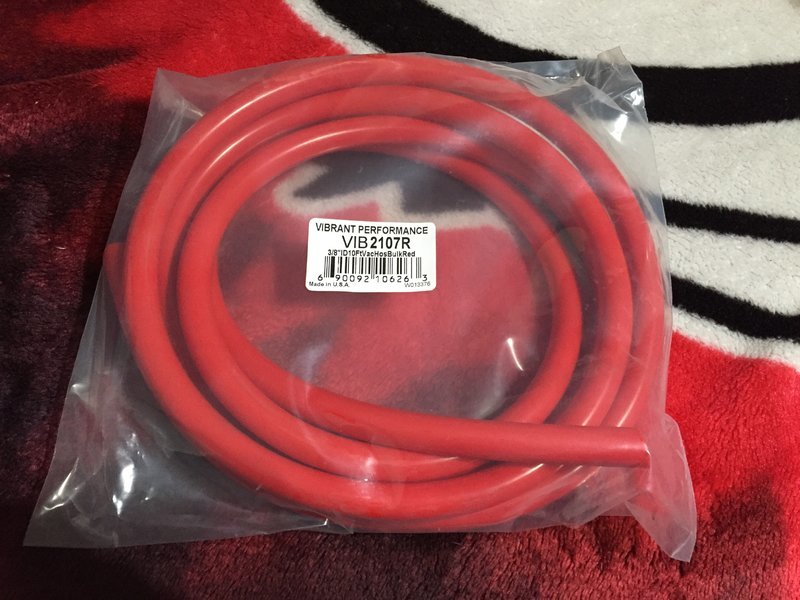

    The hoses are vacuum silicon, my bad on not reading up on silicon and oil lol!

    Some don't work with oil. Some seem to have the ability to.
    I have had a silicone hose as part of my catch can system for between 4 to 6 years. Still just as pliable as day one. No change in its integrity. Good hose that I purchased from Kozmic Motorsports. Brushes off brake-clean as well without even noticing it.

    I also have some cheaper silicone hose which was another shop's own name brand. It was much cheaper by the foot. Cannot even fold it over on itself without it cracking and breaking.
    I believe the Vibrant stuff should be pretty good. Not certain, unless that is the brand of hose which Kozmic uses.

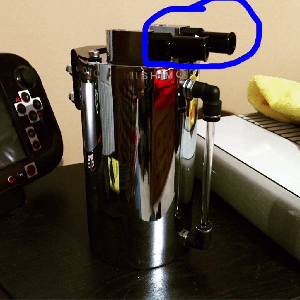

    3733a9f4ad8ba044f1ab69d389abd29f_f2f4e4f44ca53c61d8e00272e4227b330a736a07.jpg The can came in but the fittings are to big :( I'm not very mechanical especially with names of parts, what are these called? Great product BTW just have to find enough room to mount haha!

    I'd like to know the name too. I'd like some with a 90 in them.
