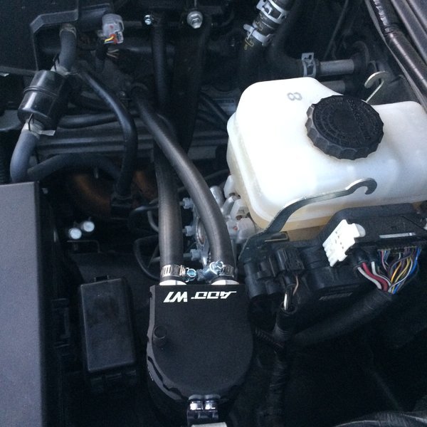

    I made a bracket that mounts to where everybody else mounts their fuse block. IMG_0932.jpg

    yeahh i thought about putting it there but my clutch revisor is right in that spot.

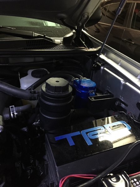

    You can see where mine went.

    Nice!! Where do the hoses run to on the S/C side?
