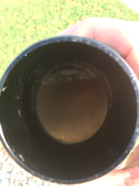

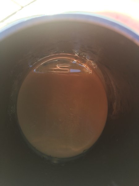

    After 800 miles!!!! Holy sh$&!!!!!!!

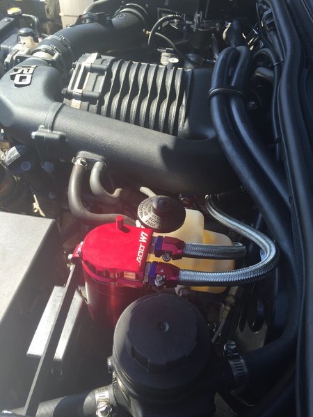

    Any have install pix of catch can on S/C? Got a 2015 AC that I'll be boosting in a few months, and wanna place catch can as well. Currently have it setup on my N/A.

    @GT7 , would you be so kind to take additional photos of your setup. Your SC LTR resevoir is in the same place as mine, and how/where you mounted your catch can is how I would like to do it. Where did you get your bracket? (Or did you make it, if so how?) where is the bracket anchored too?

    No pics for awhile, I am living in arizona but the truck is in Alberta.
    I made it, look where the bracket leads, there is two bolts, and I used them
    I got a piece if steel from home depot, measured the lengths i wanted and cut, welded, drilled holes for the bolts and painted.

    Thanks grant!
    Is it the same two bolts that the resevoir uses to attach to the inside of the engine bay? What shape is your bracket?
