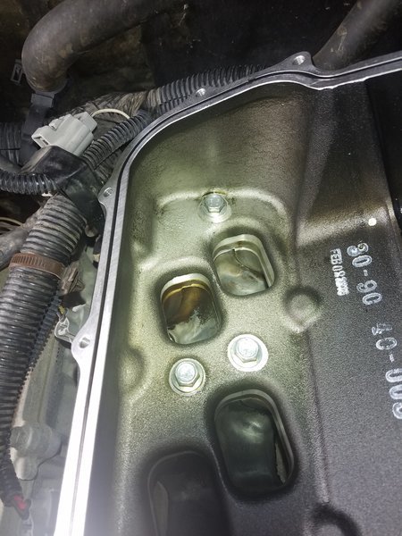

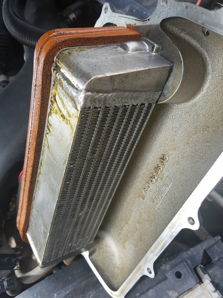

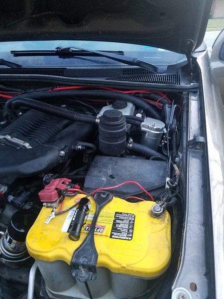

    Just installed a catch can today. Pulled the supercharger to get to the pcv valve and replaced that too. Truck has 145000 on it. Supercharger has about 10000 on it. This is the oil that is on it already. I'll pull the supercharger again in 10000 and see what difference the can has made. 20170125_171642.jpg

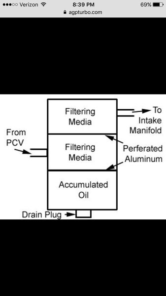

    I'm new to the supercharged Tacoma world. I had a srt-4 in the past and spent a lot of money and time on it. I had a oil accumulator from agp-turbo on mine. It's just a catch can. Looks great and worked awesome. Has different filter media in it. And they are only $100. Just an option for people.

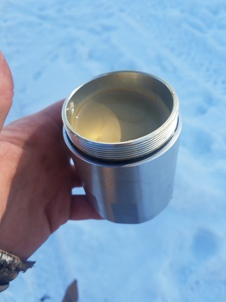

    Which State are you in?

    Brian Crower stroker kit, Carrillo pistons moly/ceramic coated, BC sportsman rods, arp s2000 head bolts, Darton M.I.D sleeves, Kelford race cams, Magnusson supercharger, hp tuner tuned, 650cc flow matched fuel injectors, CSF radiator, Walbro 255 fuel pump. pulleyboys quick change pulley with 2.3", fpr mod, NST crank, water and alternator pullies, 160° mishimoto thermostat. Puma On-board air, Radflo CDC ext coilovers with 14" 700# springs, extended length rear Radflo shocks with CDC, Dakar leak pack, Brute Force Fab front bumper galvanized and powder coated, DTRL mod, yellow fogs, fog anytime mod, relocated rear differential breather, synthetic fluids, custom airbox, tundra sized intake. 76mm throttle body, secondary air filter removed, Airflow snorkel, 4x innovation sliders powder coated, URD equal length headers, DT y-pipe, Aero-Turbine 2525xl exhaust dumped over axle, seat belt chime disabled, Warn 8000i winch, 1- 20" slim light bar in grill, 42" curved roof light both with custom brackets. Mesh grill, Brute Force Fab rear bumper with extra reverse lights, u bolt flip kit, SS extended brake lines, hockey puck bump stop extension, AT shackle flip kit, Light Racing UCA's, 4crawler 1.5" bodylift. custom built front and mid skid plates, re-geared to 4.56s, windows tinted 25%, Sony stereo, 8" skar sub-woofer, 1000 watt mono amp, retrofit headlights with legal demon eye, Kryptek Marathon seat covers. North Star agm 27f battery, Helo 791 rims, 315/75/r16 Mt/r ARB front air locker
    All of them. This trip was Florida to N.Y.

    Has a lot of moisture in it. Thus why I asked. Perfect reason.

    All of that humidity is what was trapped. Glad you caught it before it over filled. Don't want that going back into your engine.
