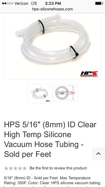

    SWEET! as of right now, I have 5/16s fuel line hoses on it, but I initially wanted them to be clear hose. so I did just that and replaced them to clear vinyl hoses... but as soon as I started the taco, both pcv valve side and intake side hoses collapse lol. so I went back and replaced them to the original rubber fuel line hoses. Does any one know what company makes high grade clear fuel line hoses? ones that wont collapse under vacuum and pressure. I at least need it to be in the intake side bc of my ADD lol. I know mishismoto cans are one of the best but still... cant be to sure unless proven wrong.

  6. May 4, 2017 at 12:25 PM
    #806
    Soul Surfer
    Soul Surfer Jimi Was Last Seen: Roam in’ Around…
    Aug 10, 2015
    #161457
    16,900
    Jimi
    West Central Florida Coast
    ‘25 TRD OR/W-UpGrade Package.
    I'm using this same hose but it's black. It fit on my 3/8 Can fittings. I purchased mine from Amazon.
    Lord Helmet and Torspd like this.
  7. May 4, 2017 at 12:53 PM
    #807
    ninja89
    ninja89 HUH?
    Jun 17, 2014
    #132154
    339
    does it hold well under vacuum? and how is it so far?
    Soul Surfer[QUOTED] likes this.
  8. May 4, 2017 at 1:51 PM
    #808
    Soul Surfer
    Aug 10, 2015
    #161457
    16,900
    Jimi
    Working Perfect!! :thumbsup:
  9. May 4, 2017 at 2:13 PM
    #809
    Watari06V6
    Watari06V6 Faster than a speeding ticket
    Feb 28, 2011
    #52042
    1,126
    Wounded Knee
    TRD-V6-SR5-06
    ordering...on Ebay...:pccoffee:
    Soul Surfer likes this.
  10. May 4, 2017 at 2:20 PM
    #810
    Soul Surfer
    Aug 10, 2015
    #161457
    16,900
    Jimi
    This is the Hose on mine.
    Drainbung likes this.

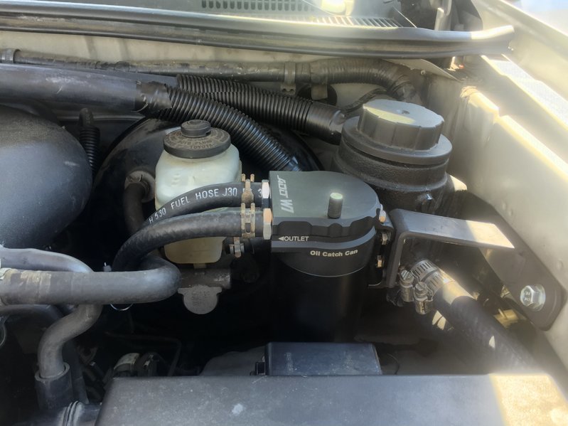

  11. May 4, 2017 at 3:42 PM
    #811
    SonnyBones
    SonnyBones I VOID WARRANTIES
    Nov 21, 2015
    #170342
    833
    Jeffery
    2015 TACOMA ACCESS CAB
    Ended up using -8 AN fittings and Earls kevlar lines.
    Torspd and Soul Surfer like this.

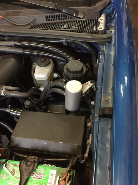

  12. May 29, 2017 at 10:26 AM
    #812
    Camby
    Camby Well-Known Member
    Sep 10, 2015
    #163939
    506
    Brian
    Denver
    2006 Tacoma TRD Off-Road
    Magnuson Supercharger TRD CAI Catch Can After market dual exhaust Heated Mirror Kit Install Aftermarket Head and Tail lights Several accessory Mods
    Install done!! (Finally, been putting this off for a few months)

  13. May 29, 2017 at 11:51 AM
    #813
    Murphinator
    Murphinator Well-Known Member
    Mar 1, 2015
    #149903
    3,335
    Anthony
    SoCal
    14 DCSB 4x4
    Is that a custom bracket? If not where did you get it? I really want to install a catch can I just havent found a good spot for it.. I like how yours is using the same bracket for the intercooler reservoir
  14. May 29, 2017 at 12:09 PM
    #814
    Camby
    Sep 10, 2015
    #163939
    506
    Brian
    Denver
    Its custom made, took a bar of 1 1/4"x1/8" steel (heavy stuff so it doesnt vibrate while driving). Cut, bend, drilled, and welded the two pieces together :)
  15. May 29, 2017 at 12:31 PM
    #815
    Murphinator
    Mar 1, 2015
    #149903
    3,335
    Anthony
    SoCal
    14 DCSB 4x4
    Awesome, I am going to have to steal your idea haha. Thanks for the info :thumbsup:
  16. May 29, 2017 at 12:32 PM
    #816
    Camby
    Sep 10, 2015
    #163939
    506
    Brian
    Denver
    Please do! If you need any help with what measurements was used or whatnot, feel free to ask
    Murphinator[QUOTED] likes this.

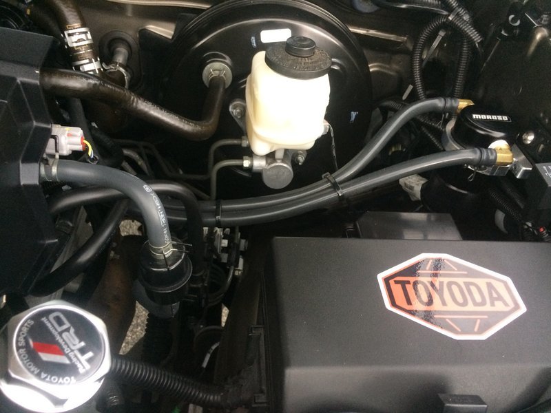

  17. May 30, 2017 at 6:51 PM
    #817
    o0opackersfano0o
    o0opackersfano0o Well-Known Member
    Oct 18, 2016
    #200102
    2,053
    Tony
    North Berwick, ME
    2005 xrunner swb
    Magnuson supercharger, 2.6 quick change pulley, 76mm throttle body, Doug thorley long tubes, urd y pipe, wot box with 2 step, 170 thermostat, airaid intake, urd short throw, djm 3/4
    Forgot to post pictures of mine. Got my agp catch can installed. It's for an evo but made it fit. Works awesome and a great product. Used for years on my srt-4 running 25 psi.

  20. Jun 21, 2017 at 9:06 AM
    #820
    Pirhett
    Pirhett Instagram @pirhett_ship
    Jan 29, 2015
    #147498
    5,219
    Rhett
    San Diego
    2014 TRD Sport 4x4 DCLB MGM
    Stock...
    which can is that?
