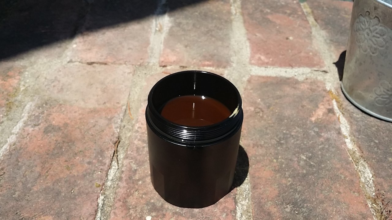

    Yes it did have filter media and looked like a chunky chocolate milk shake. I drove truck over 100 miles today with no problems so I guess using gas to clean it didn't harm anything

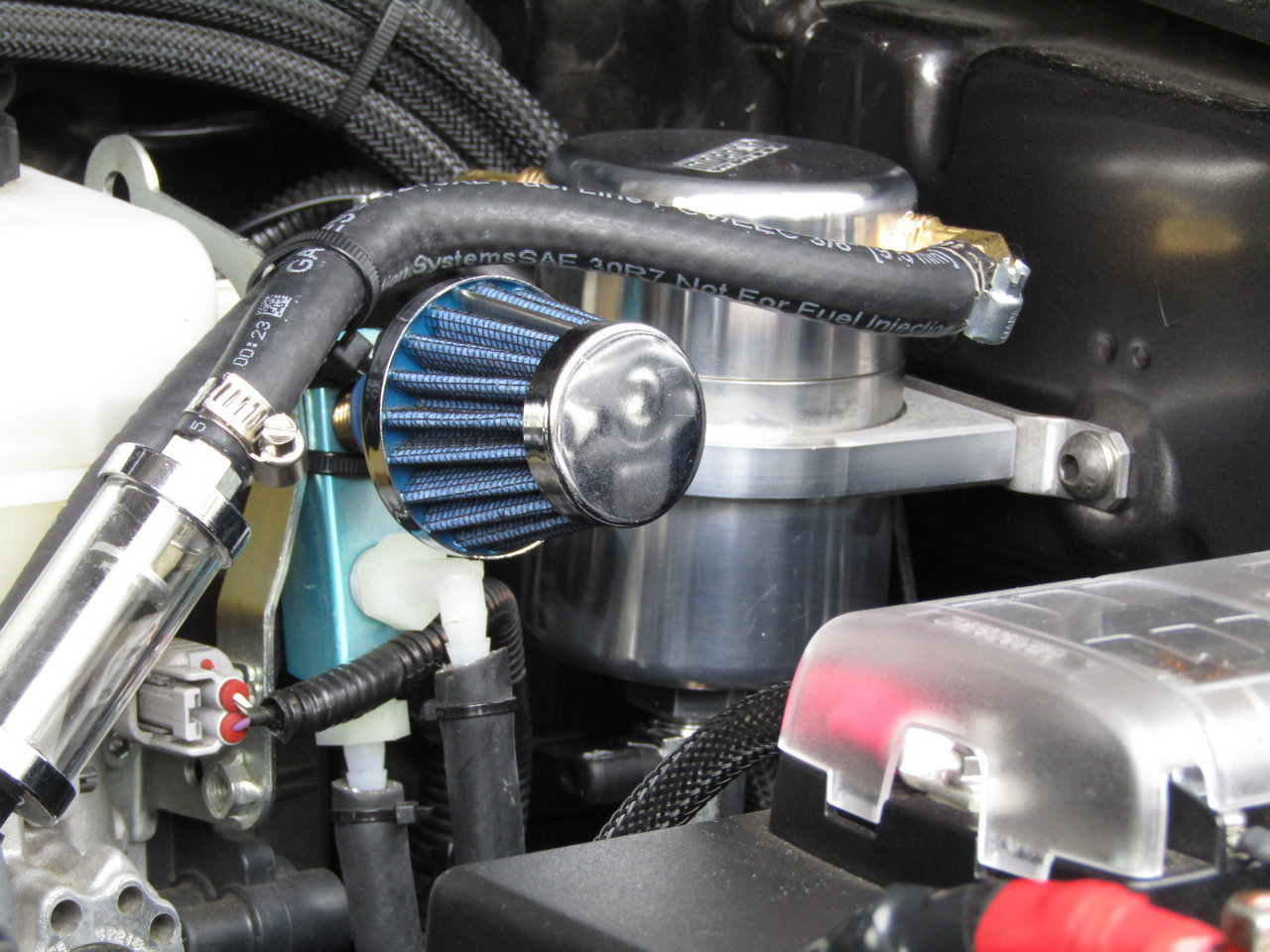

    Been looking a bit through this thread. I originally was going to install the catch can where everyone else does, but since I have a electrical box there, any other places people place theirs?

    Anywhere you can fit it.

    There is a brace that bolts to the intake...can figure a mount and mount it right there. My FJ has a threaded hole just up and to the right of where the brace mounts, but I have seen some other 4.0s (Tacomas?) don't. Can just use the brace mount bolt in that case

    You can also do in front of the battery, or in front lower where you'll access through the wheel well, or on the passenger side of the engine bay. This takes some creativity since its not a usual item to install (unfortunately)

    Can anyone suggest an alternate mounting location other than the one shown in the OP? That space on mine is currently occupied by my Bussman fuse and relay panel.

    4 posts up

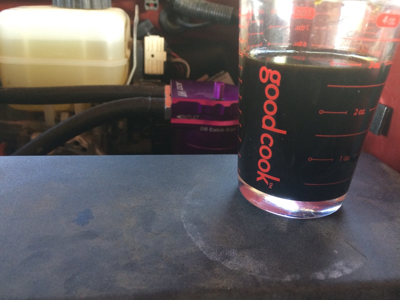

    My ADD W1 catch can had accumulated 3oz of smelly oil after exactly 5,000 miles
