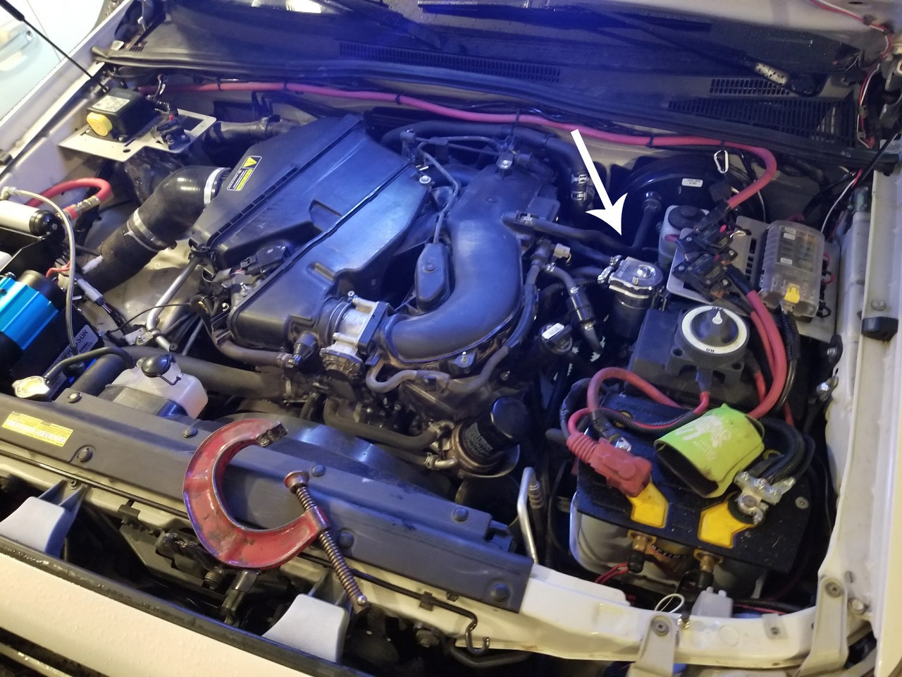

    my catch can. has done its job well for 5 years

    I go about 5,000 miles and I empty it twice in between oil changes. I must say its pretty full as well. I cant believe why anyone would want this nasty stuff going back in your intake.
    The reason I did mine too was that I kept on having bad oil samples come back from Blaskstone. Like gas in my oil, so I put this on to somewhat stop it from going back in. When I empty it, it smells like it has gas in it.

    quick question, where does the in tube attach and where does the out tube attach?

    The one tube comes off the egr valve, drivers side rear of engine, goes into in side of catch can. The out side of catch can tube goes out into where the egr hose was. Get like 41/2 feet of 3/8 rubber hose so you have enough room.
    Some guys also put an in line filter on the out port of hose to see if this junk goes back into engine.
