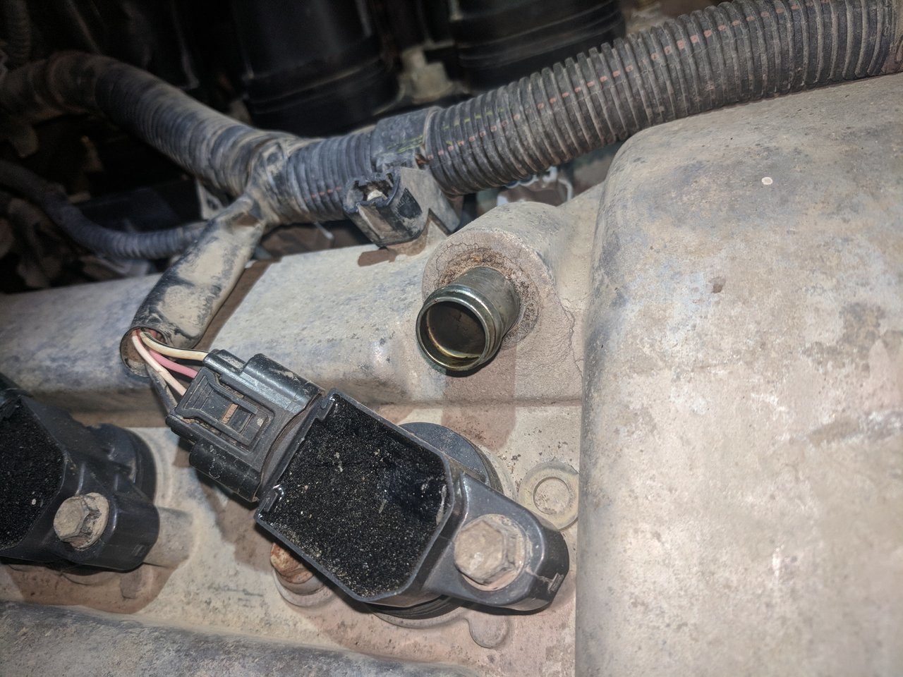

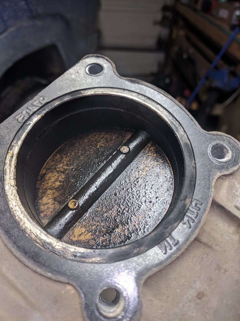

    Saves having to take apart the throttle body and cleaning out the air manifold. Took mine apart and found a mess, and from what i can tell its all from the pcvs.IMG_20180126_213521.jpg This leads to this. IMG_20180126_190345.jpg
    Which obviously leads to decreased performance.. Oil catch may not be required, but if it saves a time consuming job of scrubbing out the TB and air manifolds, like.. why not?

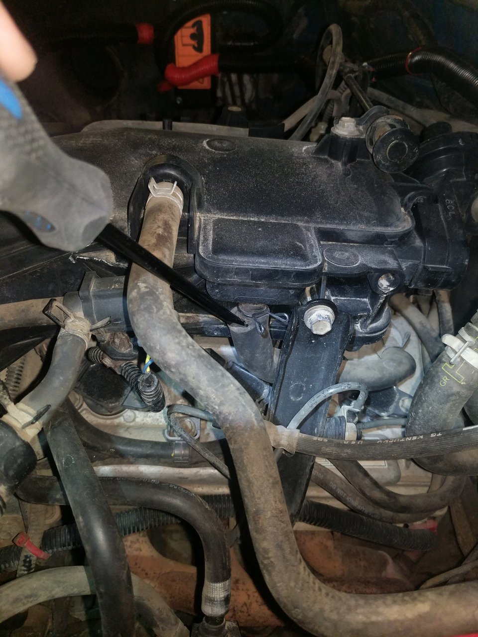

    Im up to my elbows in this, and didn't go through this whole thread, but I assume folks are doing 2 catch cans. one on the driver side,15170286503457857215426429277966.jpg and one on the pass side, which leads up the the air intake pre-throttle body and contributes greatly to build-up on the valve...? IMG_20180126_213537.jpg
    I haven't done my research and don't know the cost, but if its not foolishly expensive to add these in I imagine I'll add this my list of mods.
    Edit: Crankcase ventilation hose(on the passenger side) takes air from the intake and brings it into the crankcase to displace the air that the pcv valve is removing (on the drivers side, where people put the catch can).. If you have oil coming into the intake pre TB like in my photos, it probably means your pcv valve is shot and needs cleaning or replacing. You may disregard the above.

    That throttle body is nasty. I am pretty sure that the PCV dumps into the intake manifold, which is downstream of the TB. Which means the TB should be passing clean air only. Not sure how your TB got so bad but I would look into that.

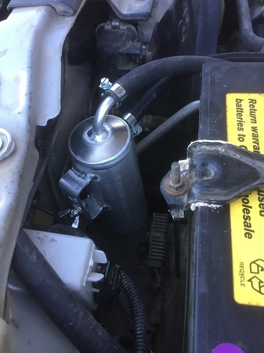

    Finally got around to installing my catch can. Didn't have any room by the fuse box; so, placed it in gap in front of the battery.

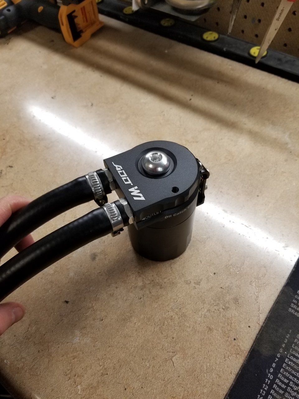

    Here is my setup. Made a custom water-jetted bracket. [​IMG]
