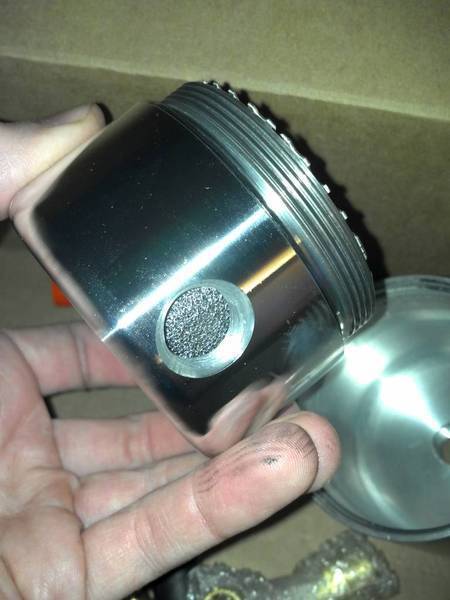

    I'll crack it open when I get it and post pictures since it was hard for me to find pictures of the inside of it. I did see one though which was promising. It showed a nice mesh for the vapors to drop out of the air on, really its the most important part... Also Moroso stuff is built for the long haul and I have first hand experience with other similar products of theirs. Yea it was expensive but for ease of install and to know what i'm getting, i'm okay with it. I almost pulled the trigger on some other cheap options but then thought "I only want to do this once"

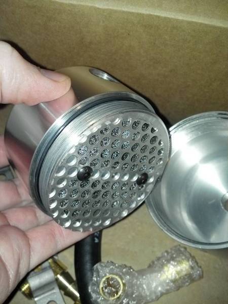

    Is that steel wool their using as a separation media?

    Yes a brillo pad :rolleyes:
    Joking aside, they call it "mesh media" it does look like steel wool but it is coarser and will not discharge the fine metal fibers you typically get from the steel wool you would buy at home depot or somewhere like that.

    Air/Oil separator showed up today. Here are a few pictures of the guts before I get to installing it this week sometime.

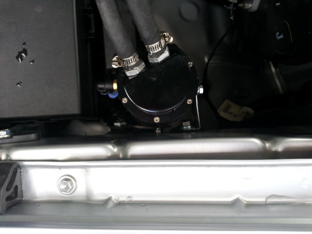

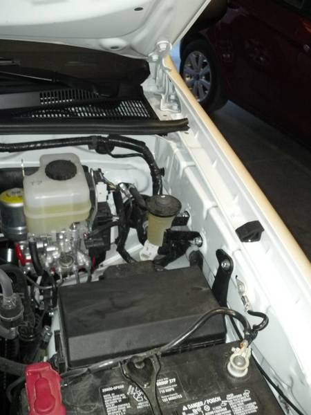

    Figuring out how to mount the catch can with some brake components in the way. Looks like the newer trucks have a new brake reservoir where y'all have been mounting the catch can :)
    Time to get creative...

    that sucks! whats on the left side of the engine bay?

    not much, but id rather have the hose runs short and in that location where the reservoir is... I think I'll make a bracket that both the brake rez and oil catch can mount on...
  13. Oct 10, 2012 at 9:02 AM
    #93
    BAMFTACO
    BAMFTACO Another day another beer
    Feb 3, 2010
    #30639
    10,904
    Juan
    Woodlandland hills , CA
    2007 Tacoma AC Prerunner
    Kings bruh
    There still no room cuz of the stupid pump that Toyota put there

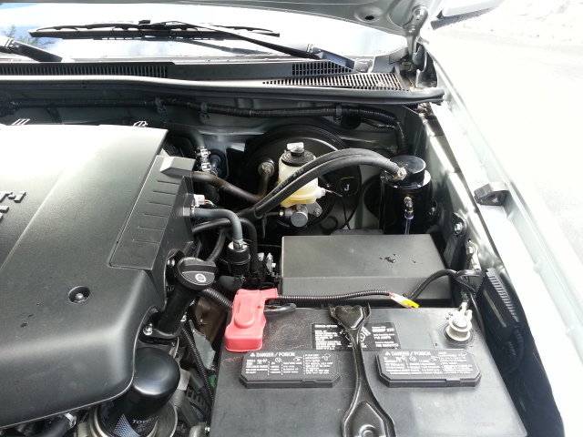

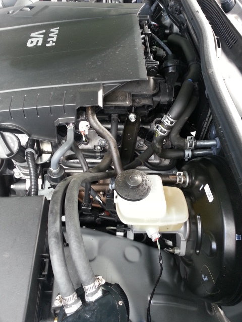

    installed:
  15. Oct 10, 2012 at 9:36 AM
    #95
    Delmarva
    Delmarva Mayor of TW
    Oct 22, 2008
    #10148
    36,628
    Tucson, AZ
    2013 4runner Limited Looking for a Taco
    It's the wife's T4R so it's stock
    ^clean, well done.

    TRD SKEWP DCSB 4x4 Silver Mica | URD TCAI/MAF CAL | BHLM | GrillCraft | FF Sliders | LED's All Around | 12v Constant On | EGR In Channel | 15% Tint | Trimmed mud flaps | Fog Light Anytime Mod | Debadged | Tailgate Hoseclamp | DTRL Switch | Disabled Lock Beep/Seatbelt Chime | Husky Liners | HID's | BedRug | WO Seat Covers | ABS Kill Switch | Oil Catch Can | Viper 5704 | Custom Carbon Cabin Filter | Backup Camera Anytime | 400W Anytime | In Cab Outlet W/USB | Firestone Ride Rites | Ams Oil All Around | 32" LED In Lower Grill | BlackVue DR500GW-HD |
    thanks
    thanks
    took about 20 minutes total. easy mod that has a lot of benefit IMO

    I like how we are bashing Toyota engineers for effective use of the engine bay... Damnit, dont they know we are all going to install these Air/Oil Separators!!! I guess if they thought of everything there would already be an air/oil separator in there... I've got some bracket ideas that i'll be working on after work today and hopefully have something together by the end of the week. Stay posted you 6 speeders with VSC (< the reason there is a second reservoir for the clutch)
