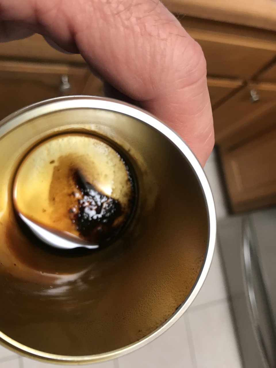

    For those who are still skeptics about the necessity of an oil catch can, here’s my reason for having installed one. This blow by deposit was destined for my valves, throttle body and who knows where else this crap ends up.FB1521B2-2187-48D1-9371-2EA4EDEEFA43.jpg
