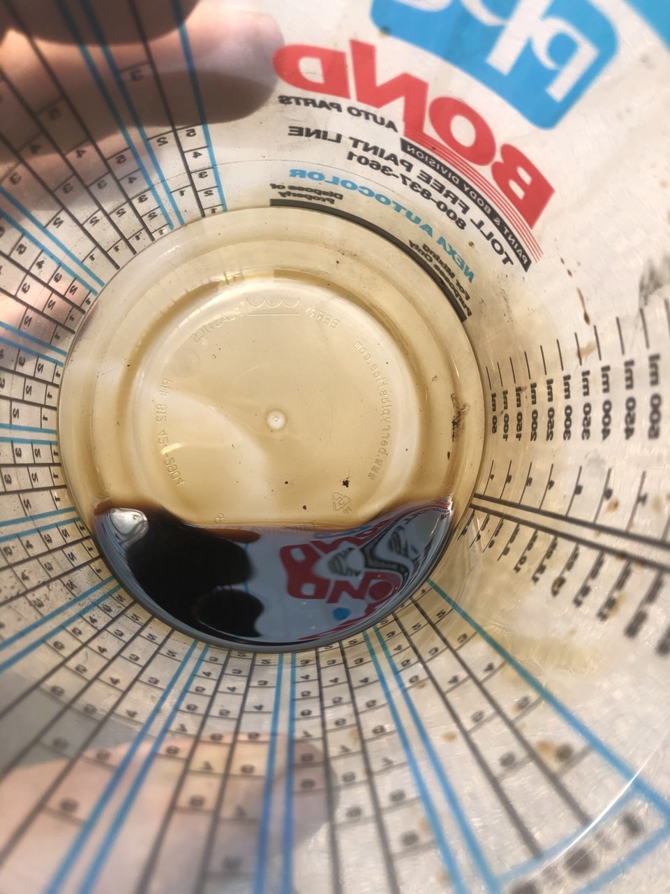

    So this is what didn’t go back thru the intake after 3k miles.
    Pretty pleased with it.
