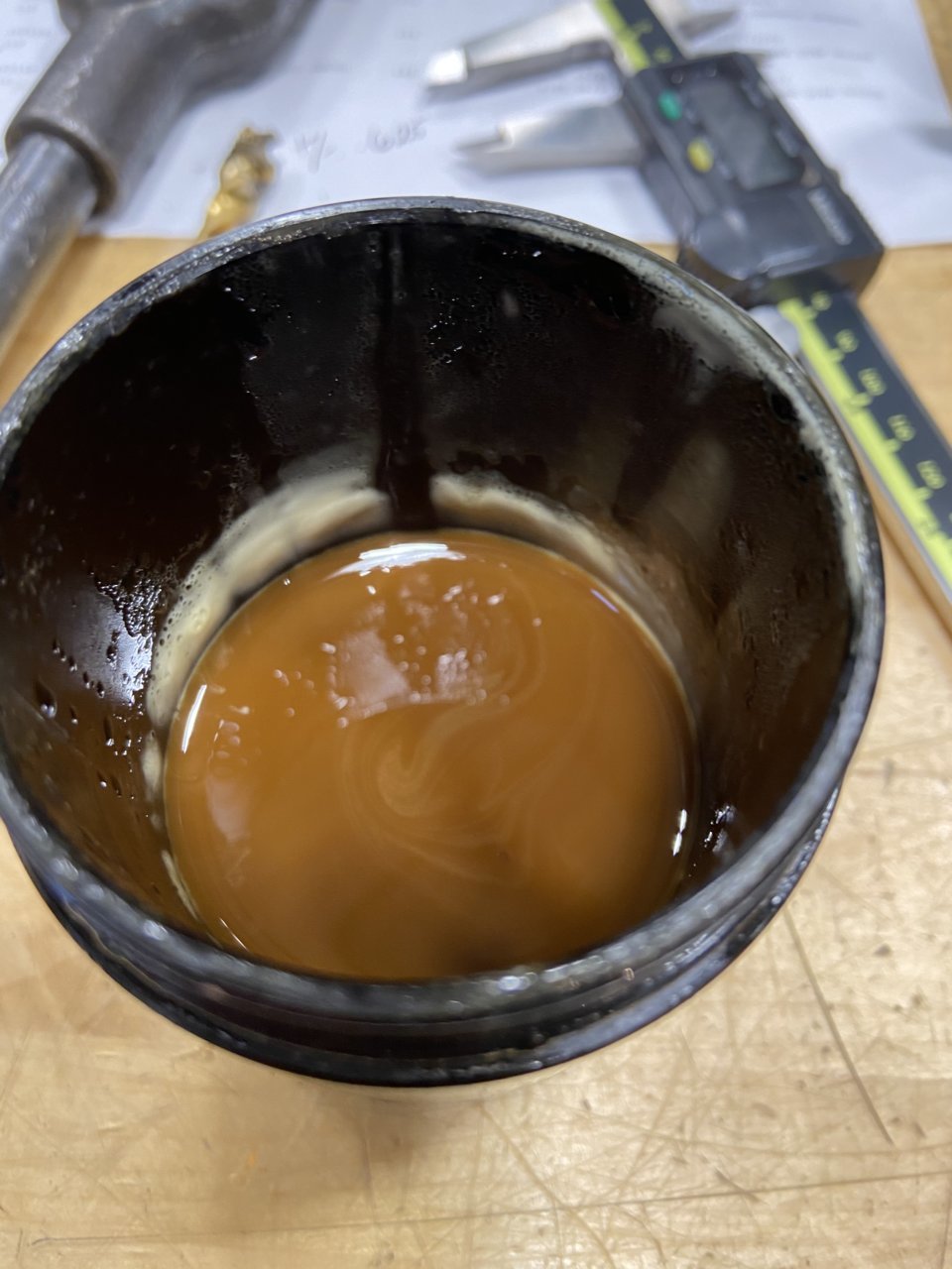

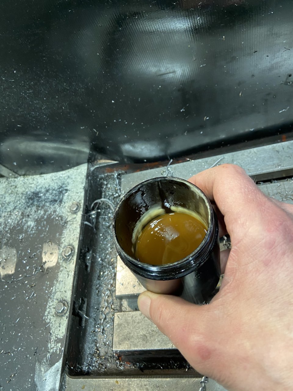

  8. Jan 18, 2020 at 12:29 PM
    #1068
    Jeffch
    Jeffch Well-Known Member
    Dec 23, 2011
    #69251
    2,996
    Jeff
    Vermont
    2018 off road
    Running 285/75/16s
    Must be more moisture etc is made during the winter months here in VT.
    Of course it has more idle time also.
    I wasn’t catching much in the warmer temps.
    I figured it’ll be a while before it needed to be emptied.
    I’m guessing at least 6k maybe 9k?
    At least this nasty crap didn’t get back in.
    No problems with freezing and we are single digits and below 0.
    8BC88A4A-954D-4647-B192-BA81AB3768E6.jpg 344E56AD-D4D0-4C10-BEF8-97C63C0D36B1.jpg
    Damm glad I added it just wish I’d had done it sooner.
    It was half full I’d say. Not sure if I’d want it any fuller it has a dip stick and that showed it full. It was still warm I did it inside but the foam crap was what made it look full.
    Drainbung, Torspd and Norton like this.
  9. Jan 18, 2020 at 3:24 PM
    #1069
    spencermarkd
    spencermarkd Well-Known Member
    May 15, 2016
    #187025
    3,000
    Spencer
    Pullman, WA
    07 Driftwood Pearl 4Runner
    I've had the same experience. Last winter the foam was on my oil cap, this year it's in the catch can. Seems like it's catching the moisture pretty well, I do mostly short trip and rarely get the engine hot enough for long enough to boil it off *shrug*
