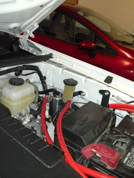

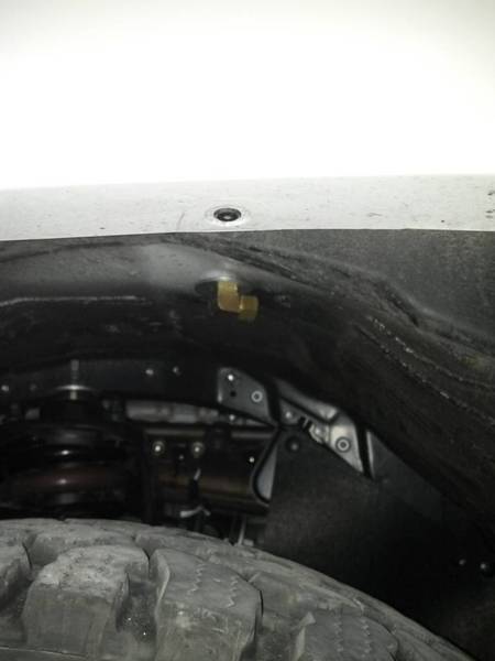

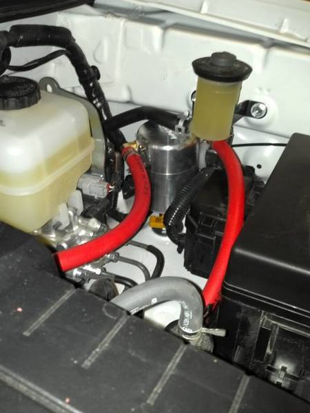

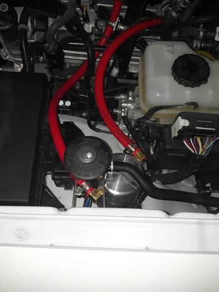

    So, first hurdle cleared I think. There was a hole in the wheel well right below where I wanted to mount the can. I popped the rubber grommet out and tried to fit the drain adapter through the hole. It fit perfectly! So, my thoughts are to run it off the wheel well structure and have it drain into the wheel well when i need to drain it, should work out perfect... Only thing that may stand in the way is the structural integrity since it will be supported by the bottom housing connections. It feels really solid and doesn't move at all. I have to get a few washers to make it complete but it should be all done by the end of the week. Here are a few pics, any thoughts by what you can see?
    ~M

    i think i would worry if you do any offroading and having your tire hit the drain.. that would be a lot of flex but not impossible IMO. looks good other than that

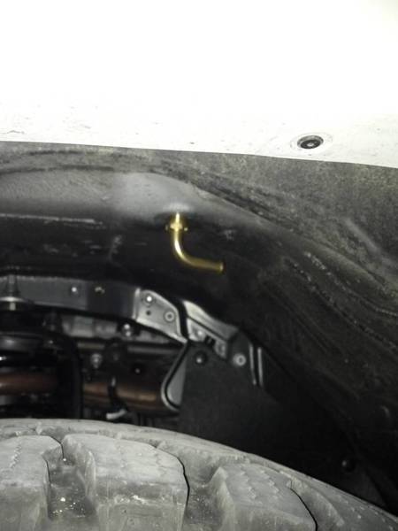

    Yea, that was just so you could see where it exits. I'm going to replace it with a shorty version when i can get to the store to find a better fitting. The hose I got is rated to 300 psi and is pretty rigid which will also help it stay put for the long run.

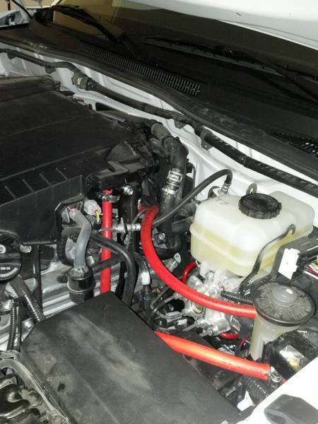

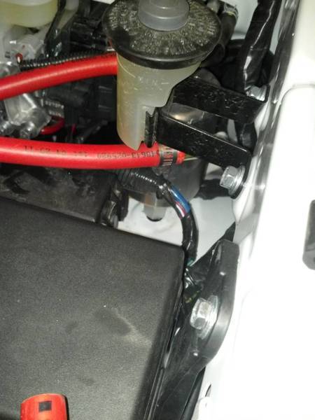

    Done. Mounted up solid as a rock!
    Everything went pretty smooth. I'll have to take it easy for a while and make sure I don't get close to my fitting in the wheel well. It is definitely out of the travel path of the suspension but crazier sh!* has happened...

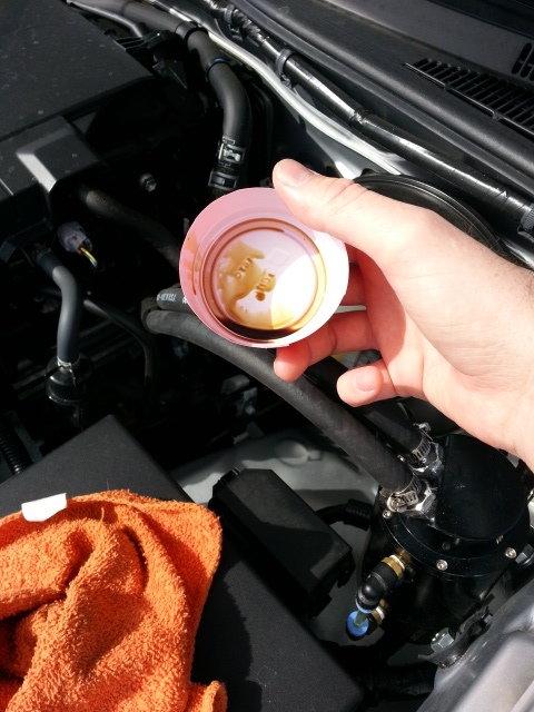

    after one tank of gas, about 300 miles

    Just shy of 22,000 as of yesterday. I bought it 11/11/11 with 7 miles on the clock
    No Prob, hope more people do this mod, its so simple and you get so much out of it IMO. I never knew how much oil was sent back into the intake creating sludge :eek:
