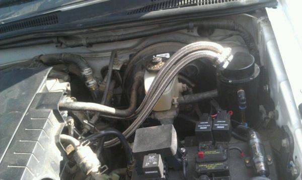

    Make sure that stainless braided stuff doesn't touch anything. Stainless is harder than most any material in the engine bay and with vibration those ribbons will cut into anything. It'll eat through a vacuum line fairly quickly if there's pressure on it.
    I put a remote filter on my first car with that stuff and had a heck of a time with hose routing. Everything it touched was getting eaten up.
    I may have to do this mod... intake sludge-o-crud sucks!

    i dont know if you trashed it, but on the OEM hose there was a foam sleeve that slid on, i slid it off and cut it in half and put it on my hoses where they touched stuff. looks OEM, you might be able to see it in my pics
    edit:
    look in the second pic, you can see it
    http://www.tacomaworld.com/forum/2nd-gen-tacomas/231227-oil-catch-can-install-guide-5.html#post5814162

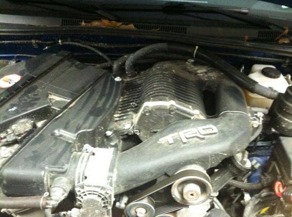

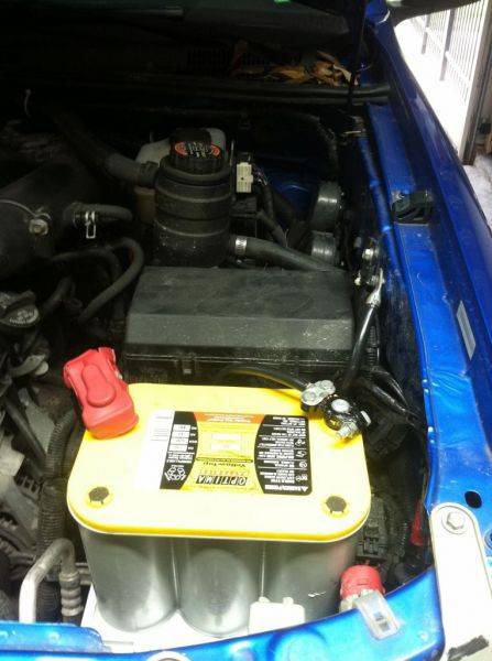

    ^ Yea it looks like you are not going to be able to fit it where we have been putting ours... Somewhere on or around the inner fender well might work? or on the frame down in the front left? Good luck.

    Super Werty did it there with the TRD charger

    Are those -6AN size lines?
