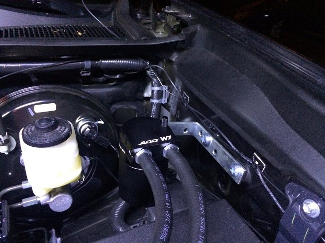

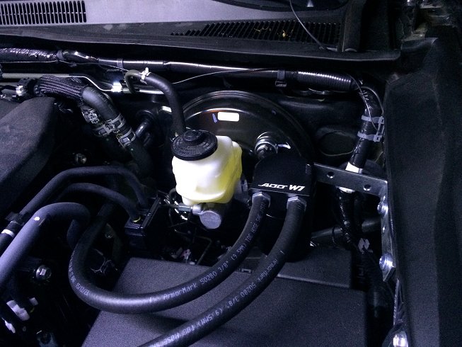

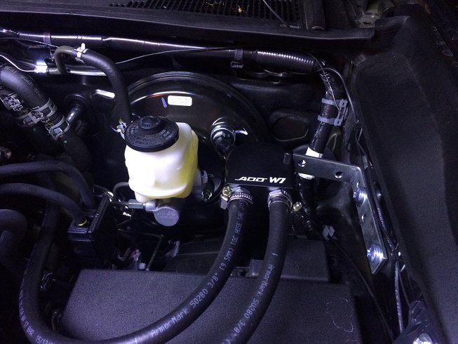

    You should install it. It's one of the first things I did after I bought my brand new truck 4 years back.
    I bought an L bracket from Home Depot and drilled a hole in the other end of the bracket. And then bought two screws of the right size and thread pitch and used the already existing threaded screw holes in the inside of the fender to mount mine.
    These were original pictures from 4 years ago. Since then I relocated my oil catch can to my engine mount, as I installed an RTMR at that original location.

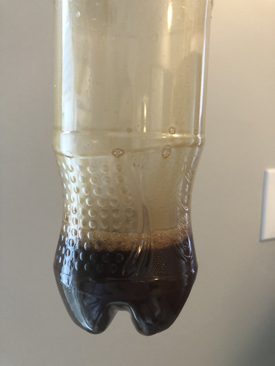

    I keep a bottle in garage with the gunk/dirty oil I collect from this can. It's now full, and you should see it. I stopped collecting bad oil from the catch can after that. This little oil catch can paid for itself many many times over.

    I don't think it's too late. It's not such an expensive mod you know. It's so well made, with precision machined Aluminum. All you need is the oil catch can. A rubber washer. A trip to home depot for some rubber tube and an L corner bracket.
    I know people might have different opinion. I have a bottle full of black goo i have collected from my oil catch can as proof to give it to any of the nay sayers.
