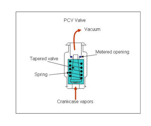

  8. Feb 24, 2020 at 5:50 PM
    #88
    Canufixit
    Canufixit Well-Known Member
    Aug 9, 2012
    #84402
    2,067
    People ask me "CANUFIXIT"!
    New England
    2020 Red SR 4x4 Taco
    "Access" Tonneau cover. Bed Mat. Hitch, Timbren SES
    pL6KYI_6Ky7NfPcHTAuJNVVDIok_F8PrZxrw08PW_5995b9e420d106882fa78b87a8f2172e4941754f.jpg
    No PRoblemo ... Also the PCV Valves themselves were designed vertically and mimic the oil catch cans in this thread and also allowed the fluid in the fumes in the valve to drip back into the valve covers.
