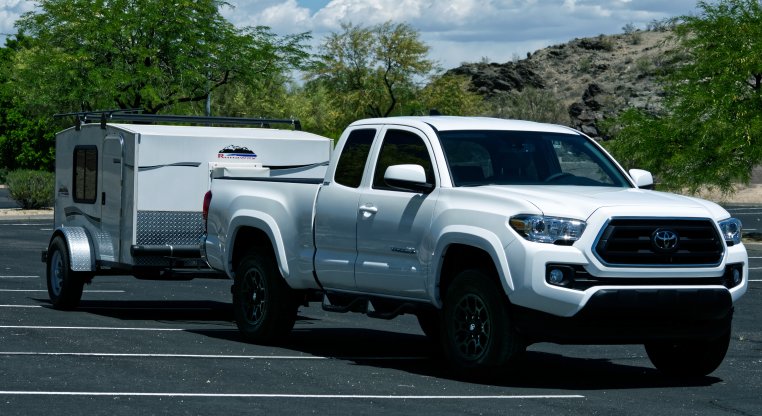

    Kinda odd I mean, while you're in the 'hood why not install a transmission cooler...
    Per VIN Specs: Eng Oil Cooler, Pwr Steering Cooler
    Wonder if towing a 1,000 pound teardrop and 200-300 pounds in the bed in the
    Arizona heat would matter that much... what say ye: Install one or not.

    Fiddly dee they should have kept 'em... we had one installed on the Subaru but tow capacity is like 1500 pounds.
    Subaru towed the little teardrop like a champ - I figure with the V6 and higher tow capacity it shouldn't be that big
    of a deal. But I'll probably add for peace of mind. The little camper is 'little'... I mean if you have issues backing into
    a spot you just unhitch .. lift it up and walk the damn thing into perfect position. I roll it out of and into the driveway
    by hand at a slight incline.
