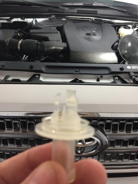

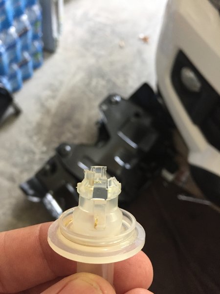

    See anything out of place? It looks like one of the 3 prong things was a little short....

    They're supposed to push in, drain the oil and remove the o-ring from what I've read. I think the threaded one will be just fine. :thumbsup:

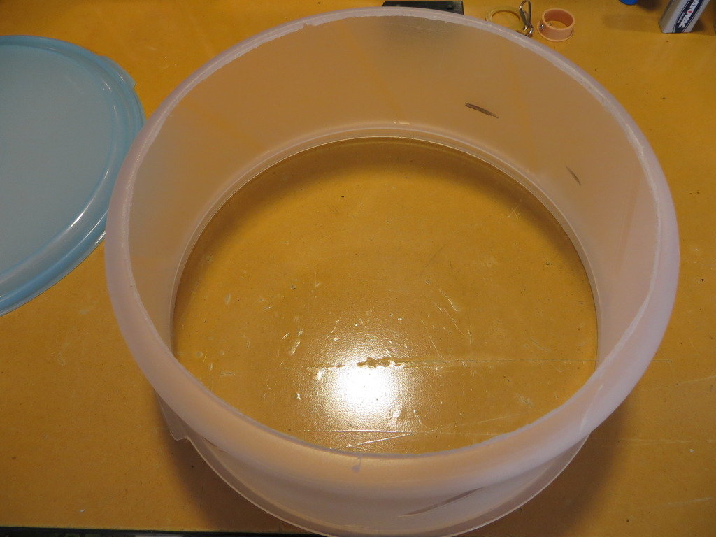

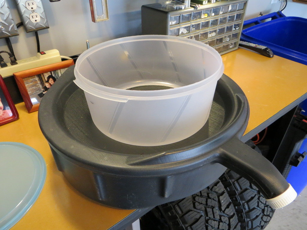

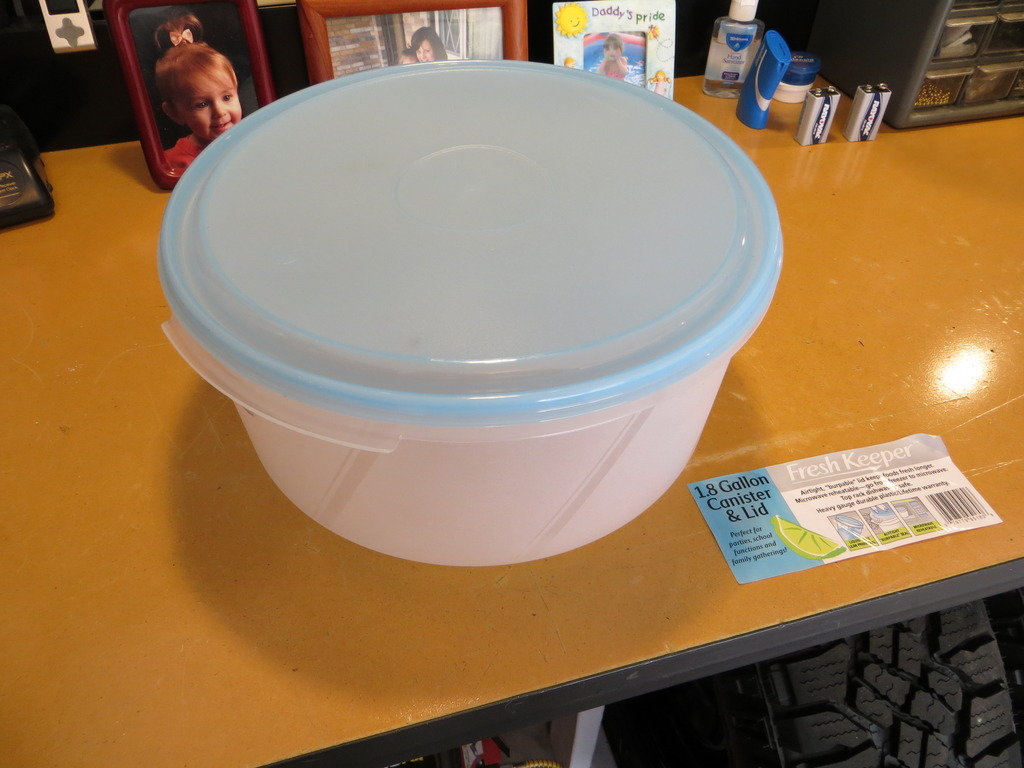

    $3 plastic container. Cut out the bottom. Zero splatters. Problem solved. Clean it out and use it next time.

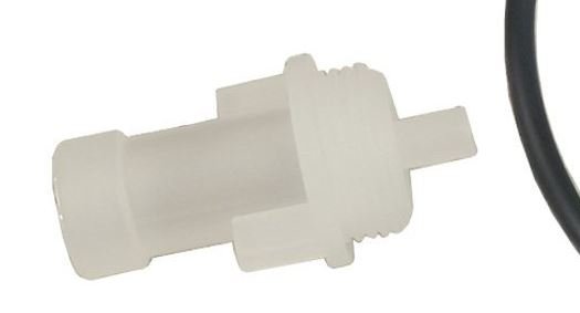

    These push-in drain tubes are a PIA. You may prefer the threaded style.
    These, among others, have threads: Bosch, Beck-Arnley, Mann, Purolator.
    I saved the first one I saw and now use it with Wix XP filters, which carry the push-in type.

    Can you purchase just the threaded drain tube somewhere? I already bought a box of Toyota oil filters off Ebay and they all are the push in type.
