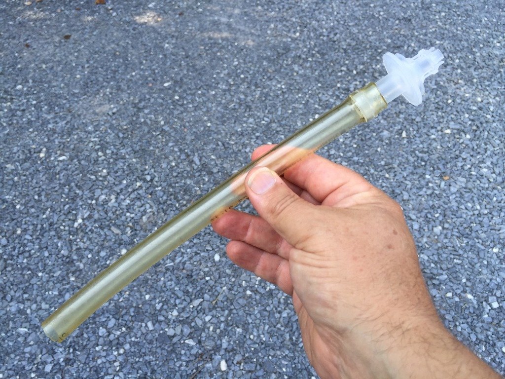

    They are nice adapters but once you change the canister type out a couple times it gets easier. I do the wife's RAV4 every 5k and it takes only a couple extra minutes. The plus side of a canister filter is you can inspect every inch of the oil filter media.
    This works great when draining oil out of the canister and only cost 20 cents from Lowes:
